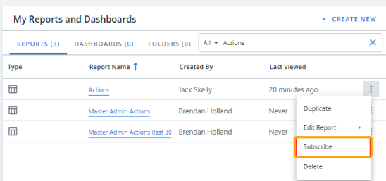

    Tip: If the report or Dashboard is accessible through the "My Reports and Dashboards" window, you can select See More → Subscribe to create a subscription for it.
    If you do this, skip to Step 4.

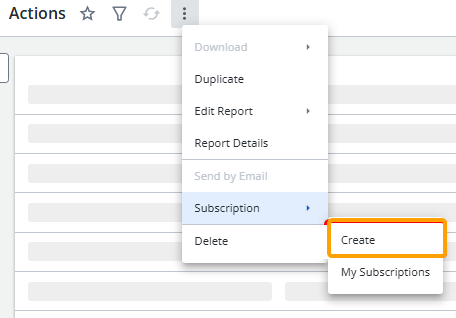

  3. Select See More → Subscription → Create from the top of the screen.

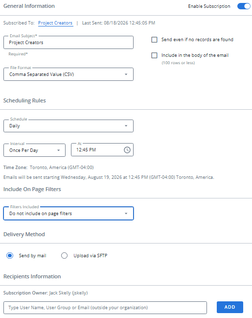

  4. Configure the "General Information" fields for the subscription.
    • Enable Subscription: Toggle this switch to turn the subscription on or off. The subscription will only be sent to recipients if the switch is blue.
    • Email Subject: Enter in the text that will appear in the subject line of the subscription email. This will also serve as the subscription's name in Upland Analytics.
      Note: "Subscription:" will automatically be appended to the beginning of the subject line in the actual email.
      Tip: If the report or Dashboard will have multiple subscriptions attached to it, consider using a unique name so it can be easily identified.
    • File Format: Use the drop-down menu to choose the type of file the report or Dashboard will be downloaded as.
      Note: The choices will differ based on the type of report.
    • Send even if no records are found: Select this checkbox to send out the subscription to recipients even if it does not contain any data.
    • Include in the body of the email (100 rows or less): Select this checkbox if you would like the report to appear directly within the email. The download link will still be included in the email as well if this is selected.
      Note: This option is only available for "Table" and "Pivot" report types.
  5. Configure the "Scheduling Rules" for the subscription.
    Tip: Be sure to mind the "Time Zone" information at the bottom of the "Scheduling Rules" section. It may be important if you plan on sending the subscription to recipients in different time zones.
  6. Determine how filters will be included in the linked report/Dashboard using the "Filters Included" drop-down menu.
    • Do not include on page filters: The subscription will always be sent with the unfiltered report.
    • Include applied on page filters (Static): The subscription will use the on-page filters that are currently applied on the report. These filters are locked in and will not change, even if you update the on-page filters later.
    • Include saved on page filters (Dynamic): The subscription will always use the most up-to-date version of your saved on-page filters. If you change your saved on-page filters later, the subscription will reflect those changes the next time it runs.
      Tip: If there are no saved on-page filters, you can select Include saved on page filters (Dynamic) option as a placeholder so that when on-page filters are saved in the future, they will be automatically included in the subscription.
  7. Select which "Delivery Method" to use for the subscription.
    • Send by mail: The subscription will be sent out via email to the recipients chosen from the "Recipients Information" table below.
    • Upload via SFTP: The subscription will be automatically transferred to the configured SFTP server whenever it runs.
      Note: An SFTP connection can be established by navigating to Analytics Settings → SFTP Settings.
      Note: Selecting this will remove the "Recipients Information" settings. If you would like to select this option, skip to Step 9 below.
  8. Choose the subscription's recipients.
  9. Select the Save button in the bottom right-hand corner of the page.

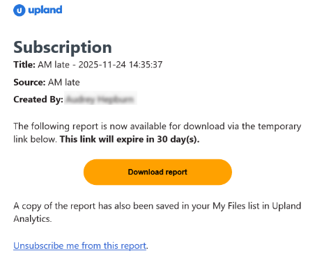

Users can unsubscribe from Upland Analytics subscriptions directly from the subscription email itself. Doing so will stop any additional emails from the subscription in the future.
To unsubscribe from a subscription via email:
  1. Open up the subscription email.

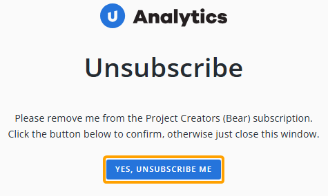

  2. Select Unsubscribe me from this report at the bottom of the email.
  3. Select the Yes, unsubscribe me button on the webpage that opens up.
After selecting Yes, unsubscribe me, you will be removed from the subscription as a recipient. You will no longer receive the subscription when it gets sent out.
