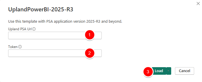

To establish the connection, complete the following steps:
  1. Open the template file (UplandPowerBI-2025-R3.pbit) in Power BI Desktop.
  2. Enter the required connection parameters:
    1. Upland PSA URL: https://yourcompanyname.tenrox.net
    2. Token: Generated from the Configuration Settings for Power BI in the PSA application:
      1. In PSA, click Integrations .
      2. Select Power BI.
      3. From the Configuration Settings for Power BI page click Generate.
      4. Click Copy to Clipboard.
  3. Click Load.
  4. Power BI will connect to PSA and load the sample Power BI Tables defined in the template. Once the data is loaded, you can review and modify these Power BI Tables in Power Query and use them to build your own semantic model and reports.
