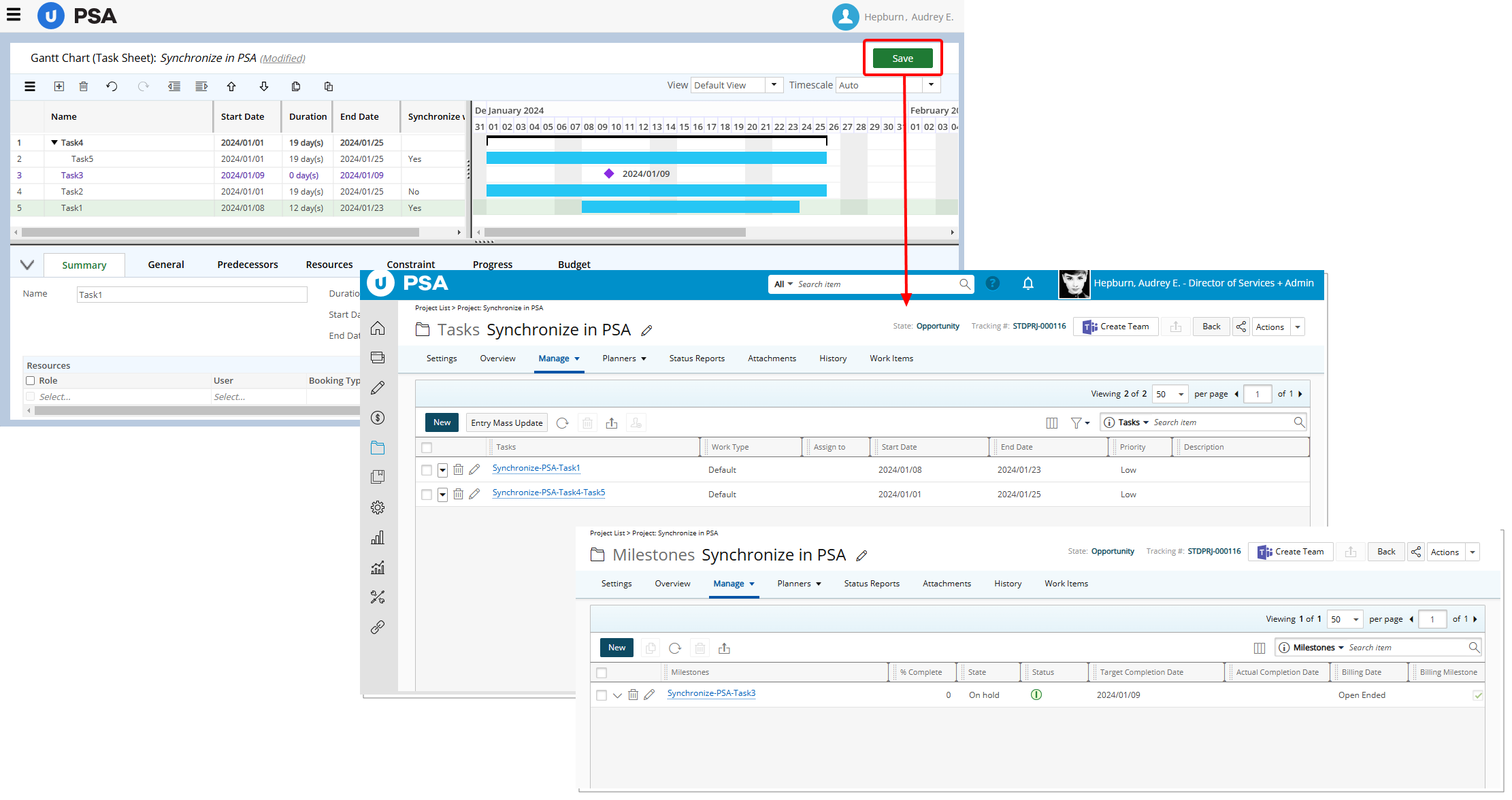

You can prevent a Task from being created in PSA, simply by unchecking the Synchronize in PSA selection box in Project Planner. Upon saving your Project in Project Planner, the Task will not be added to PSA, and if the Task already exists in PSA, it will be removed, provided there are no Entries already made against it.
This allows to distinguish between planning activities and time-tracking tasks which are synched in PSA.
- The Synchronize in PSA selection box is checked by default.
- You can check/uncheck the Synchronize in PSA selection box at any time. Upon saving, any Tasks for which the Synchronize with PSA selection box is checked, will be created/udated in PSA.
- The Synchronize in PSA selection box is unavailable for Milestone and Summary Tasks.

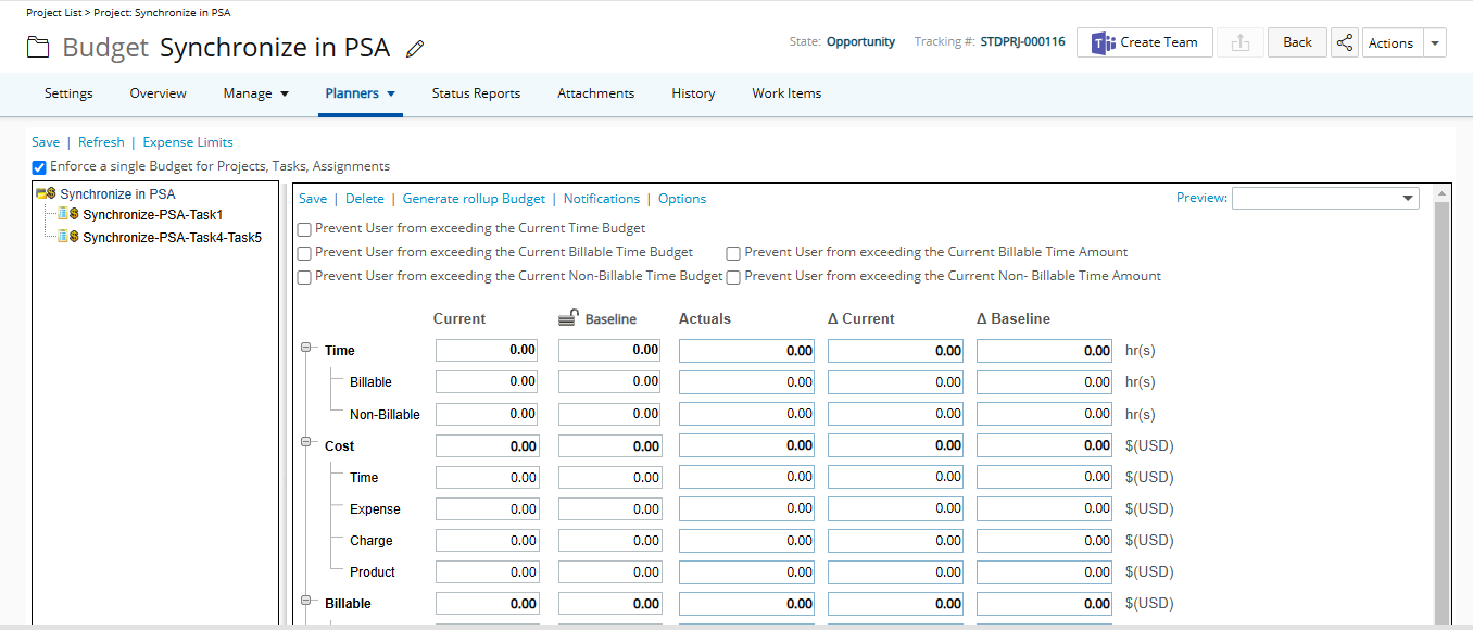

Unsynched Tasks (planning activities) will not have a Budget and will not be included in the Project overall Budget in PSA. You can assign a User to planning activities, however these tasks will not appear in Timesheets, Project Work Plan or anywhere else in PSA.

Let's assume we have the following Tasks:
Synchronize with PSA | When Project is Saved in Project Planner | |
Task 1 | Checked | Task is Synched |
Task 2 | Unchecked | Task s only available in Project Planner |

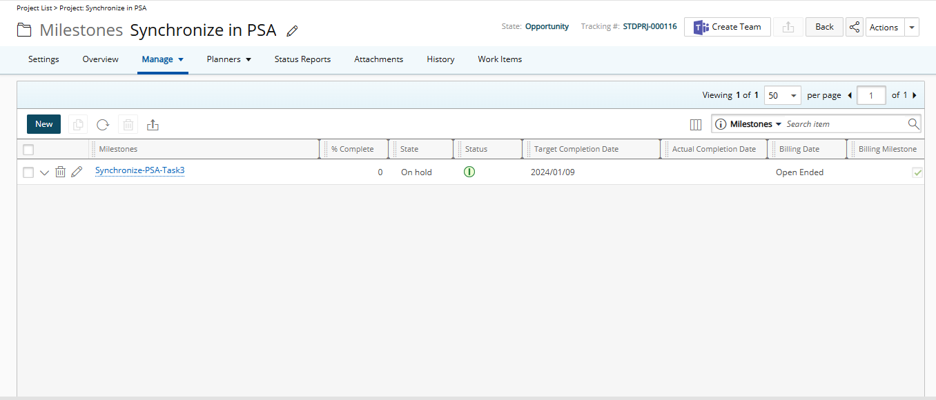

Task 3 (Milestone Task) | Checkbox is unavailable | Existing Behavior (Milestone Tasks are Synched) |
Task 4 (Summary Task) | Checkbox is unavailable | Existing Behavior (Summary Tasks are not published in PSA) |
Task 5 (Summary Task) | Checked | Task is Synched |
In the above scenario, you will see:
- Task 1 and Task 5 are synched and available in PSA
- Task 1 and Task 5 are included in the overall Project Budget in PSA
- Task 3 is a Milestone Task in PSA
