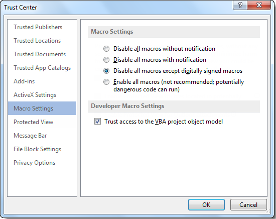

  4. Select Macros Settings from the left side menu.
  5. Select the Disable all macros except digitally signed macros radio button.

    Example of the Macro Settings tab of the Trust Center in Microsoft Word. Click to enlarge.
  6. Click OK.

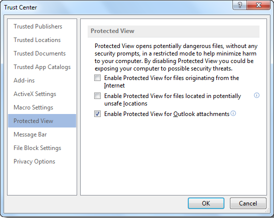

  1. Select Protected View from the left side menu.
  2. Clear the Enable Protected View for files originating from the Internet and Enable Protected View for files located in potentially unsafe locations check boxes.
    Example of Protect View tab of Trust Center in Microsoft Word 2013.
    Example of the Protect View tab of the Trust Center in Microsoft Word. Click to enlarge.
  3. Click OK, and then click OK again.
