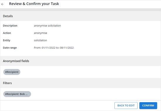

Use the submit your task button to save and review your task details.
Select confirm to proceed.
In the data management window, select your anonymisation task to open the task details.
Confirm the details are as you expect. If not, you can make changes using the edit task button. If the details are correct, use the start your task button to anonymise your solicitations.
