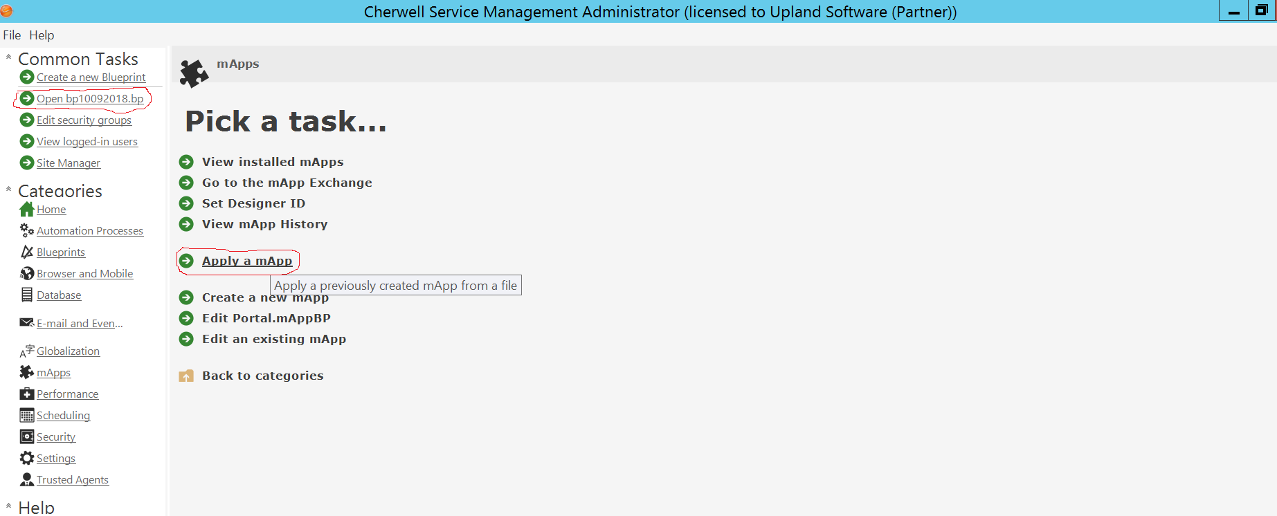

  1. Login to Cherwell Administrator and apply the RightAnswers Integration blueprint/mApp into your Cherwell instance. Image
  2. Now browse to your respective .bp or .mAppBP file.

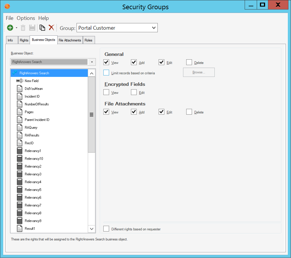

  3. Configure the permissions for the portal users and groups in the Common Tasks > Edit Security Groups.
  4. A Security Groups popup will open. Select each portal group and perform the following steps for each.
  5. On the Business Object tab, grant these groups View, Add, and Edit permissions to the integration Business Objects viz: RightAnswers Search and RightAnswers Attached. Image
  6. Verify that the View and Edit permissions are applied to all the fields in the Business Object.

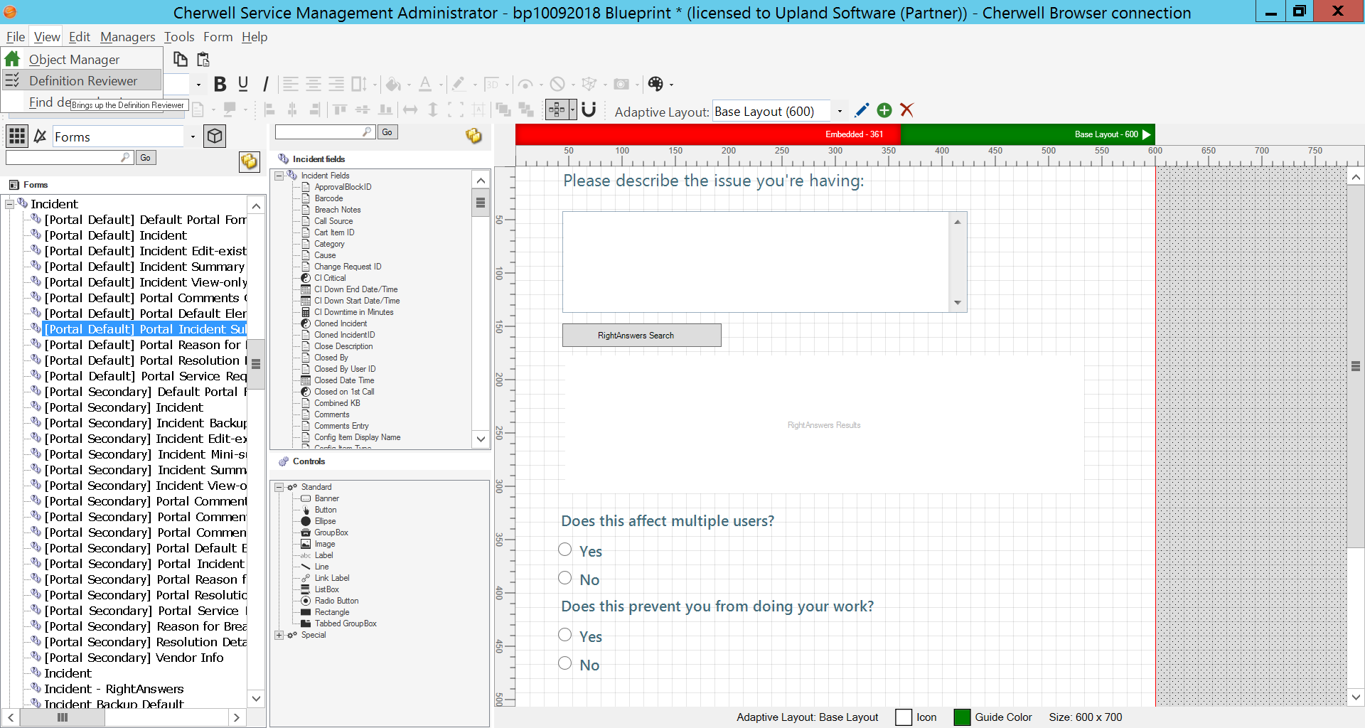

  9. To apply the integration to other portal forms, navigate to Document Reviewer. Check the changes to the Incident (Portal Default) form, and apply the similar changes to your respective form. RightAnswers Search Button and RightAnswers Results section are additions to this form. Image
