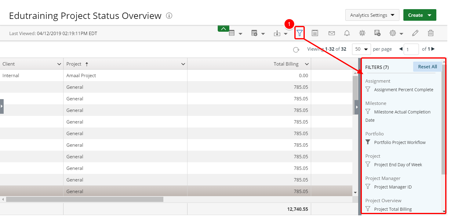

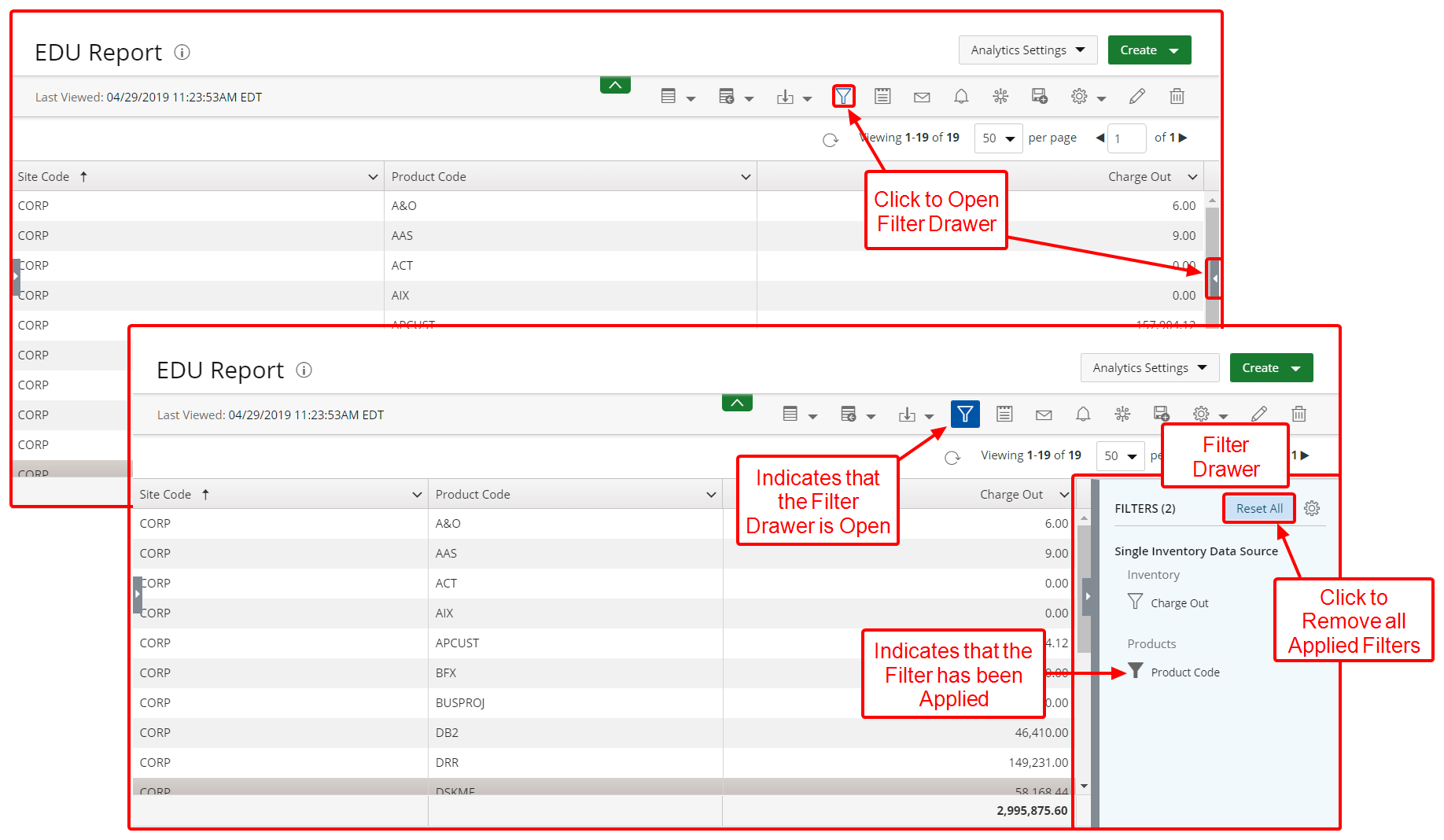

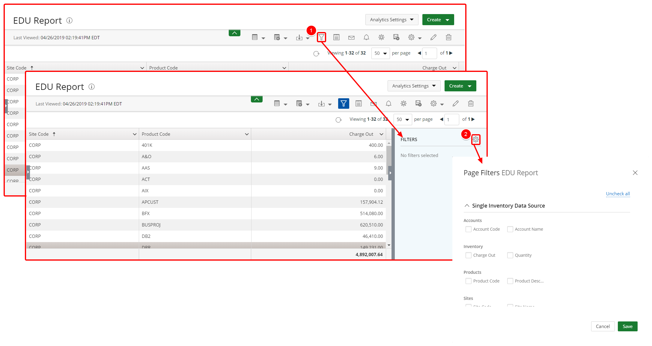

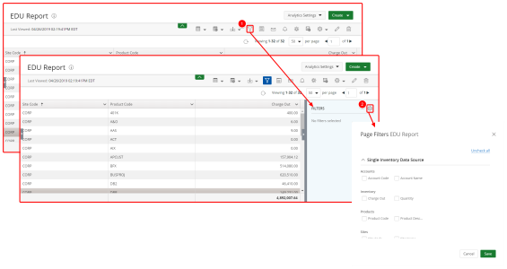

1. Access the Page Filter Tab
  1. Click the Filters button to open the Filter Drawer.
  2. Click the Settings button. The Page Filter tab displays.

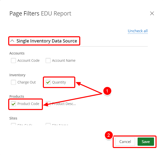

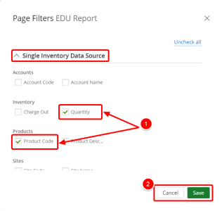

2. Add Page Filter(s)
You will see a list of all available Filters categorized by View.
  1. Select the Filter(s) you wish to allow the users running the report to have access to.
  2. Click Save or Cancel to return to the previous page.

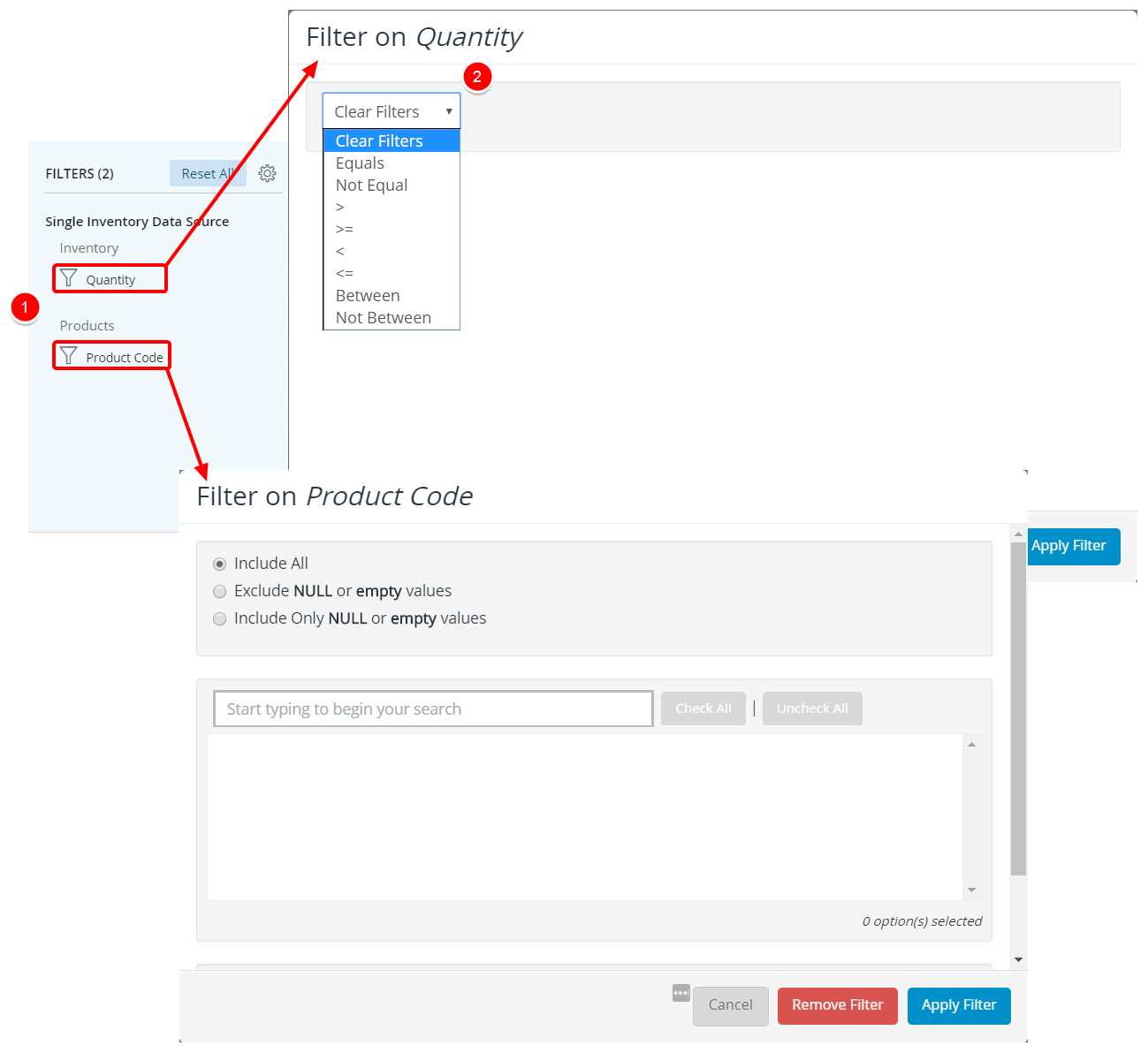

3. Apply the Filter
  1. In the Filter Drawer, select the filter. The filters that are available to you depend on the data type.
  2. Click Apply Filter. The filter icon changes to indicate that the filter is applied.
4. View On Page Filters
  • The selected Page Filters are now available to the report Users to utilize as necessary.
