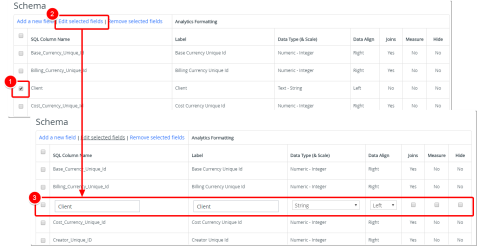

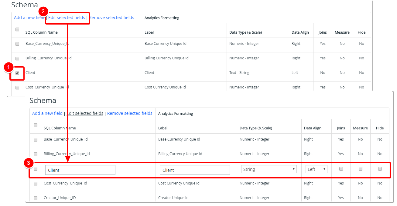

3. Edit Selected Field
  1. Select the Field(s) you wish to edit
  2. Click Edit selected fields located in the Schema section.
  3.  In-line Editing will be turned on for the selected fields and you can make the necessary changes:
    • SQL Column Name: Type the necessary SQL Column Name.
    • Label: Type a Label for the SQL Column Name.
    • Data Type (& Scale): The data type is a label and a guideline for SQL to understand what type of data is expected inside of each column, and it also identifies how SQL will interact with the stored data. Select a Data Type (& Scale) from the available options:
      • Select Text and then choose String.
      • Select Numericand then choose from Integer, Decimal, Percent or Money.
      • Select Date/Timeand then choose from Date, Time, Date Time, Hour of Day (0-23), Day of Week (1-7) or Time Lapse (Seconds).
      • Select Aggregate Dateand then choose from Week, Month, Month Year, Quarter, Quarter Year or Year.
      • Select Othersand then choose from Boolean (True/False), User ID (String) or File Size (Integer).
    • Data Align: Select a Data Align option from the available options:
    • Joins:
    • Measure: Select if the Field is a Measure
    • Hide: Select if the Field should be hidden from view.
  4. Repeat Step 1-3 above to edit more than one Field.

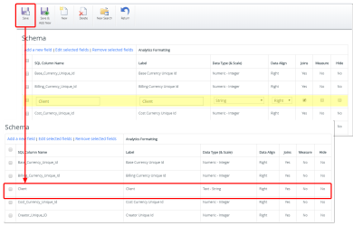

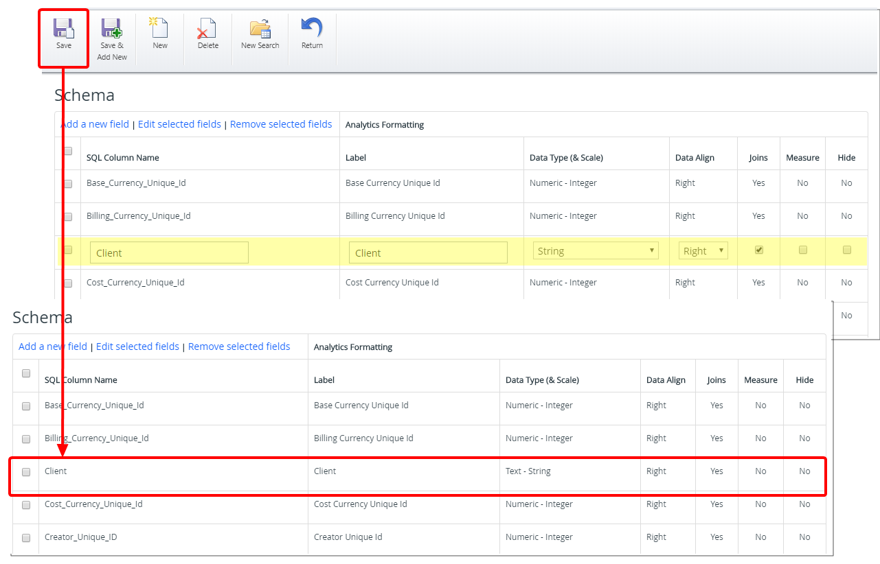

4. Click Save
  • Click Save to apply your changes.
