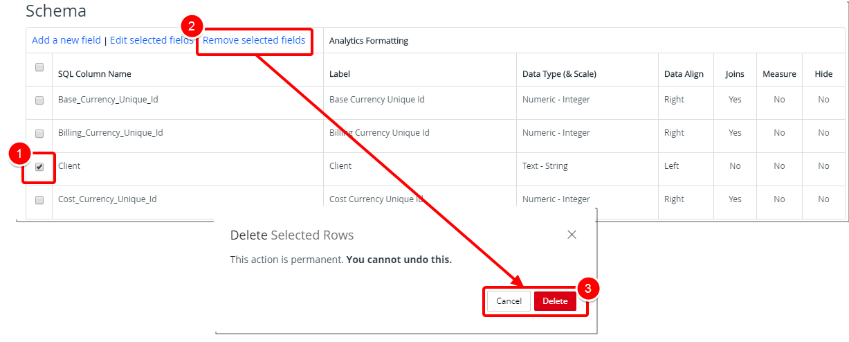

3. Remove Selected Fields
  1. Select the Field(s) you wish to remove
  2. Click Remove selected fields located in the Schema section.
  3. Within the confirmation box, click Delete to confirm or Cancel to return to the previous page.
  4. Repeat Step 1-3 above to delete more than one Field.
Note: Deleting a Field is a permanent action, and you cannot undo once the action is completed.

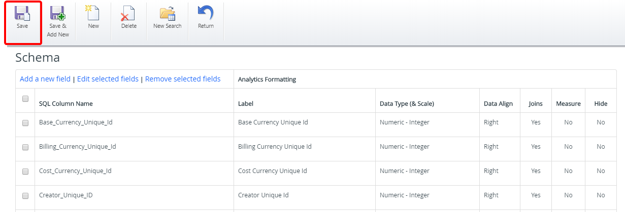

4. Click Save
  • Click Save to apply your changes.
