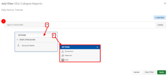

- In the Type or choose field field do one of the following:
- Type the name of the field.
- Click the drop-down arrow and select the field from the drop-down menu.
- Select the field that you want to add to the filter from the drop-down menu. After a field is selected, the operator drop-down arrow displays.
- Click the drop-down arrow next to the operators field and select the operator to add to the filter. The following operators are available:

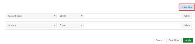

- Optional: Click Add Filter to add another field to the filter and then repeat steps 6 - 8.
- Click Apply.
A drop-down menu displays all fields in the report.
Note: Click the All Fields drop-down arrow to sort the list by field type.
