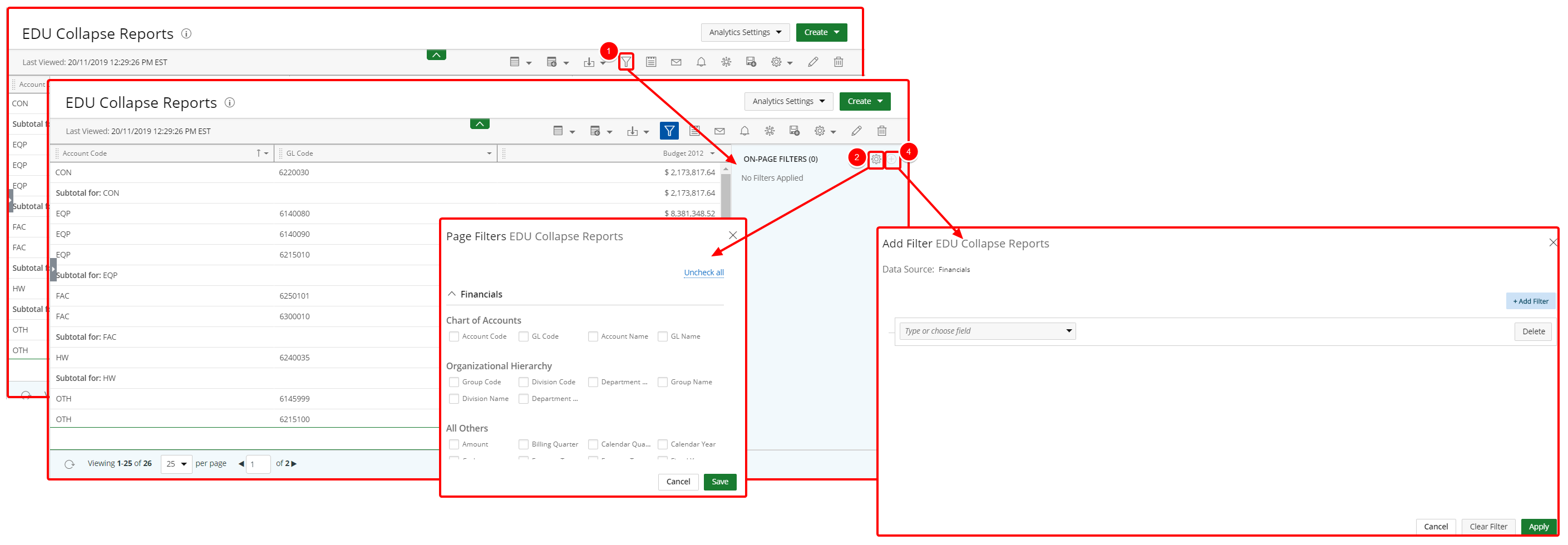

Apply an On-Page Filter
- From an existing report or graph/chart, open the Main Menu bar and click
to open the Filter Drawer. - Click
to select the fields on which you want to filter. The Page Filters dialog box displays. - Click the checkbox next to the fields on which you want to filter and click Save.
- Click
. The On-Page Filter dialog box displays.
Note: This step is not needed if the fields were selected when the report or graph/chart was created. For more information, see the report or graph/chart settings topic.
- In the Type or choose field field do one of the following:
- Type the name of the field.
- Click the drop-down arrow and select the field from the drop-down menu.
- Select the field that you want to add to the filter from the drop-down menu. After a field is selected, the operator drop-down arrow displays.

- When necessary, type or a select an operator value in the field.
- Optional: Click Add Filter to add another field to the filter and then repeat steps 6 - 8.
- Click Apply.
A drop-down menu displays all fields in the report.
Note: Click the All Fields drop-down arrow to sort the list by field type.
