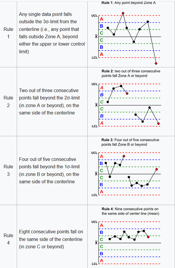

The chart's rules are not configurable, they display automatically depending on the data. The chart is based on the four rules of Western Electric:

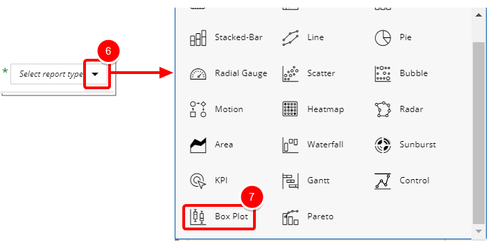

To create a Box Plot:
- All Fields
- Dimensions
- Measures
- Date
- Click
Click one of the following:
