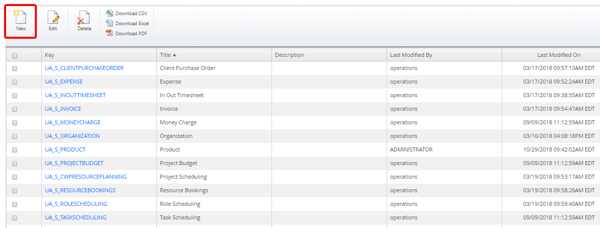

  2. The Data Sources page displays a list of all available data sources.

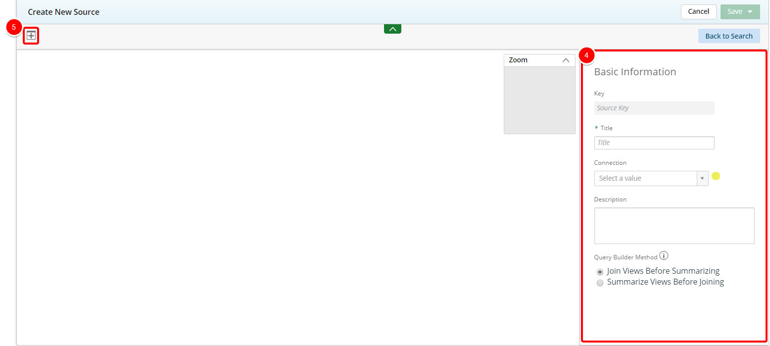

  1. Click New. The Create New Data Source page displays.
  2. In the Basic Information section, enter the following information:
    • Title: Type a name for the data source. This field is required.
    • Connection: Select a connection from the drop-down menu.
    • Description: Type a description for the data source.
    • Query Builder Method: Select one of the following:
      • Join Views Before Summarizing: Views used in the query will be joined before applying filters and summarizing. This is the default.
      • Summarize Views Before Joining: Views used in the query will be summarized and filtered individually before joining them.
    Note: The Key is generated automatically.

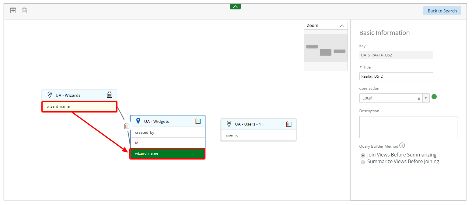

  3. Click . A list of available data views display.
  4. Select one or more data views from the list.
  5. Tip: The Relationships section will be displayed once more than one data view is selected.

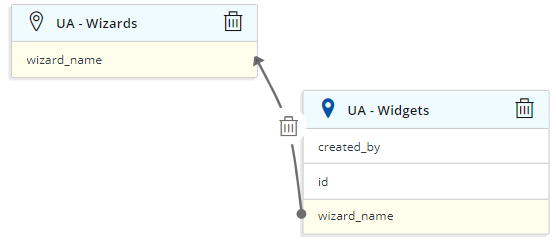

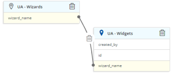

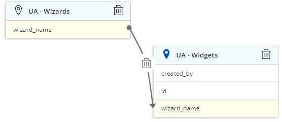

  6. Drag and drop one field onto another field to make a connection. A connection line displays.

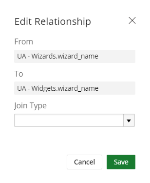

  7. The Edit Relationship dialog box displays.
  8. From the Join Type drop-down menu, select how the relationship should be connected:
    • Left
    • Right
    • Inner
  9. Click Save.
