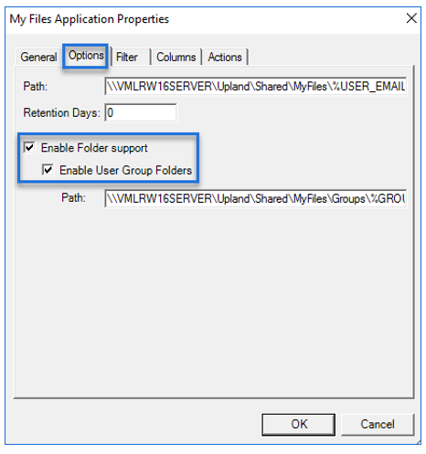

  5. Select the Options tab.
See the My Files Application Properties dialog box example below.
Note: A default path to send documents to a user’s email address is predefined for you. You can set the number of retention days for users’ documents by using the Retention Days box.
  1. Select Enable Folder support.
Note: Choose Enable Folder support only if you want users to manage their own personal folders and not group folders.
  1. Select Enable User Group Folders.
Note: Choose both Enable Folder support and Enable User Group Folders if you want users to manage their personal and group folders.
  1. Use the default path or specify your own in the Path box.
Note: Use the same Path naming convention \\Servername\....\RootFolderName when specifying your own path and root folder.
  1. Select OK on the My Files Application Properties dialog box.
  2. Select OK on the Profile Properties dialog box.
