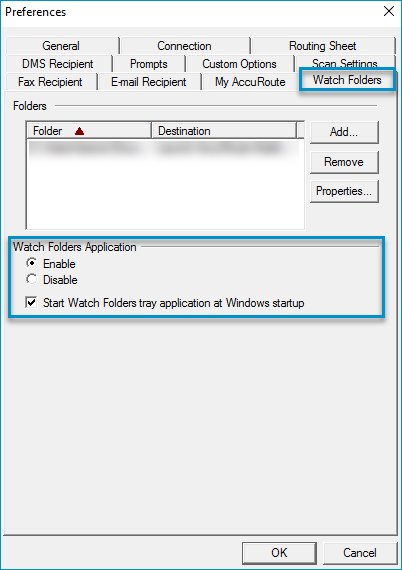

Watch Folder
A Watch folder application is automatically configured and enabled for WebApps Client use. The WebApps DMS Document Profiling feature will not work if it is disabled. No additional configuration is required.
See the Desktop Client > Tools Preferences dialog box example below.

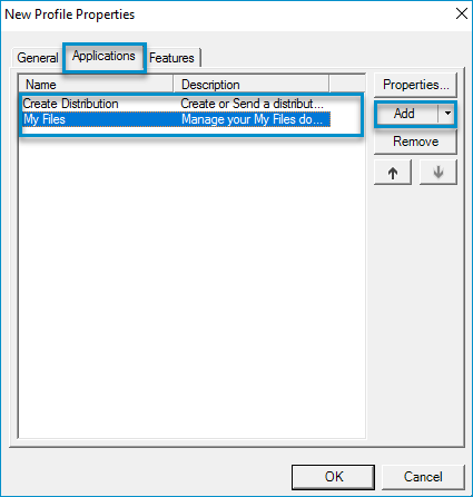

To add web applications to a profile
- Start the Server Administrator.
- Expand Configuration on the Server Administrator tree.
- Right-click WebApps . The Properties shortcut menu appears.
- Select New > Profile. The New Profile Properties dialog box appears.
- Type a profile name in the Name box.
- Type a description in the Description box.
- Select the Applications tab.
- Select the Add button. The Applications shortcut menu appears.
- Select the appropriate application; for example, Create Distribution and MyFiles.
- Specify the General, Options, Attachment Permissions, and Actions parameters, if necessary. The applications appear in the Name and Description table.
- Click OK.
See the WebApps > New Profile Properties dialog box example below.

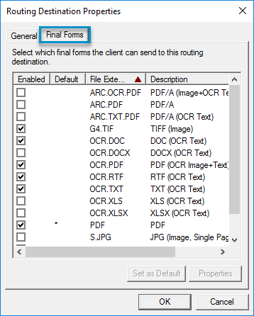

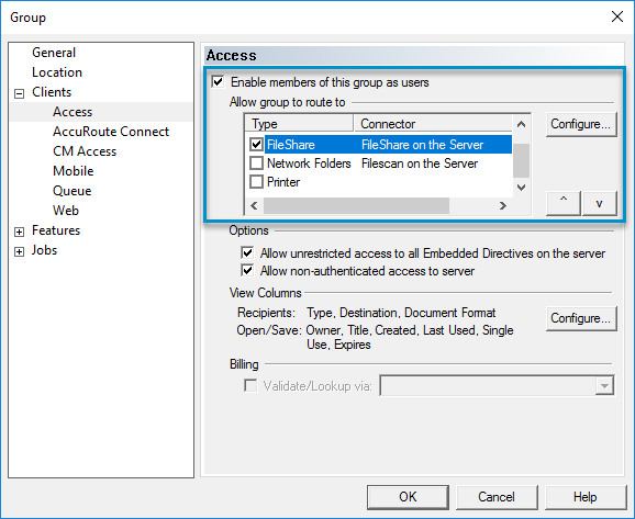

Groups > Client Access and Final Forms
User permissions are assigned via groups. Administrators can configure client options, prompts, scan settings, and more for each group. Groups are also used to assign access to a company’s document management system. In addition, final forms must be set up. These are the formats; for example, PDF that WebApps users will select for their routing destinations.
To provide groups client access and identify final forms
- Select Groups. The Default and other groups previously created appear in the Groups details pane.
- Select the appropriate group. The Group Properties dialog box appears.
- Expand Clients, if necessary, and select Access.
- Ensure the Enable members of this group as users check box is selected.
- Choose the Allow group to route to (DMS) type from the Type/Connector table and click Configure.
- Select the Final Forms tab and choose the appropriate formats that the Client can send to the routing destination.
- Click OK on the Routing Destination Properties dialog box.
- Click OK on the Group Properties dialog box.
Note: These forms will appear in the WebApps Client when the WebApps user creates distributions.
See the Group Properties > Client Access and Configure > Routing Destination Properties > Final Forms dialog box examples below.
