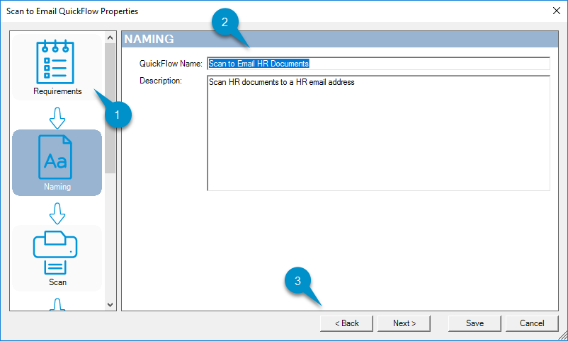

                                            You can use the QuickFlow Wizard to configure workflows based on your company’s requirements. The wizard is also used to edit QuickFlows. See Edit a QuickFlow for more information.
See the QuickFlows Wizard below.
QuickFlows Wizard at a Glance
                                                             QuickFlows Wizard Legend  |
                                                             Description  |
                                                         1. QuickFlows Wizard navigation pane with icons  |
                                                         Use the icons to go back or to the next step in the wizard.  |
                                                         2. QuickFlows Wizard step pane  |
                                                         Use the QuickFlows Wizard step pane to:
                                                         3. QuickFlows Wizard navigation buttons  |
                                                         Use the buttons to:
