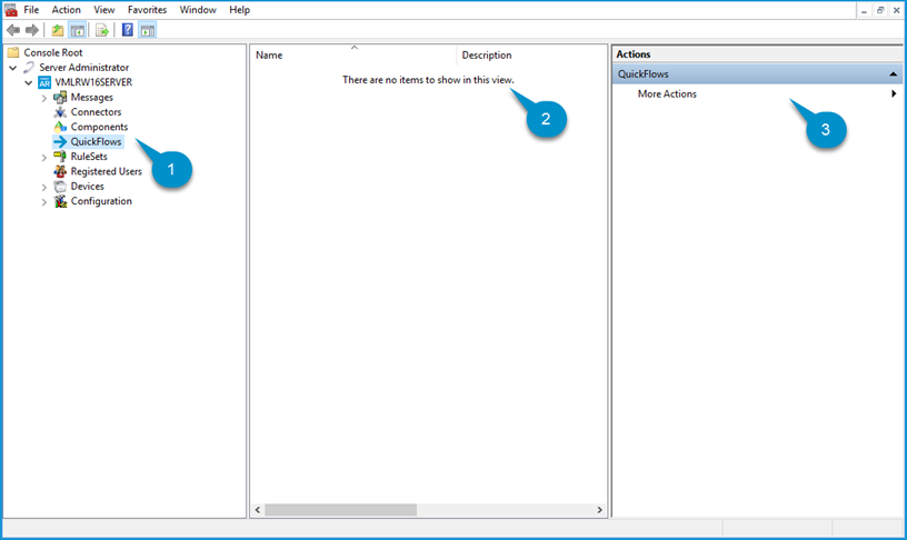

QuickFlows at a Glance
QuickFlows Window Legend
1. MMC Scope (Server Administrator) pane
Use the MMC Scope (Server Administrator) pane to:
  • View and access all Server Administrator functions including QuickFlows.
  • Create new QuickFlows with the New menu.
Note: MMC is an acronym for Microsoft Management Console.
See About Server Administrator for more information.
2. MMC Result (QuickFlows) pane
View and access saved QuickFlows.
Note: The QuickFlows pane is blank when there are no saved QuickFlows.
The following message appears: There are no items to show in this view.
3. Actions pane
Create new QuickFlows with the More Actions > New menu.
Tip: Any of the panes can be expanded to view more information if the QuickFlows window is resized. See how below.
To expand a pane
  1. Place the mouse pointer on the pane border.
  2. Click the pane border, if necessary. The mouse pointer becomes a double-arrow.
  3. Drag the double-arrow to the right or left  to view more or less information.
