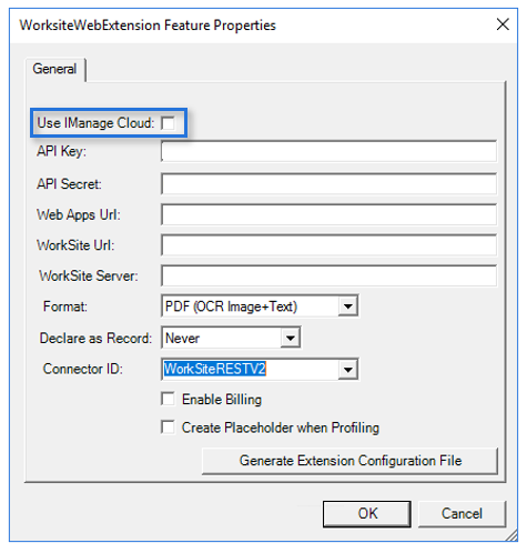

  • The WorkSite extension must be set up in the Server Administrator.

  • Contact iManage and AccuRoute Support to get the WorkSite extension registered for your account.
  • The WorkSiteRESTV2 connector must be set up. See iManage Cloud Server – Setting up WorkSiteRESTV2 connector for more information.
