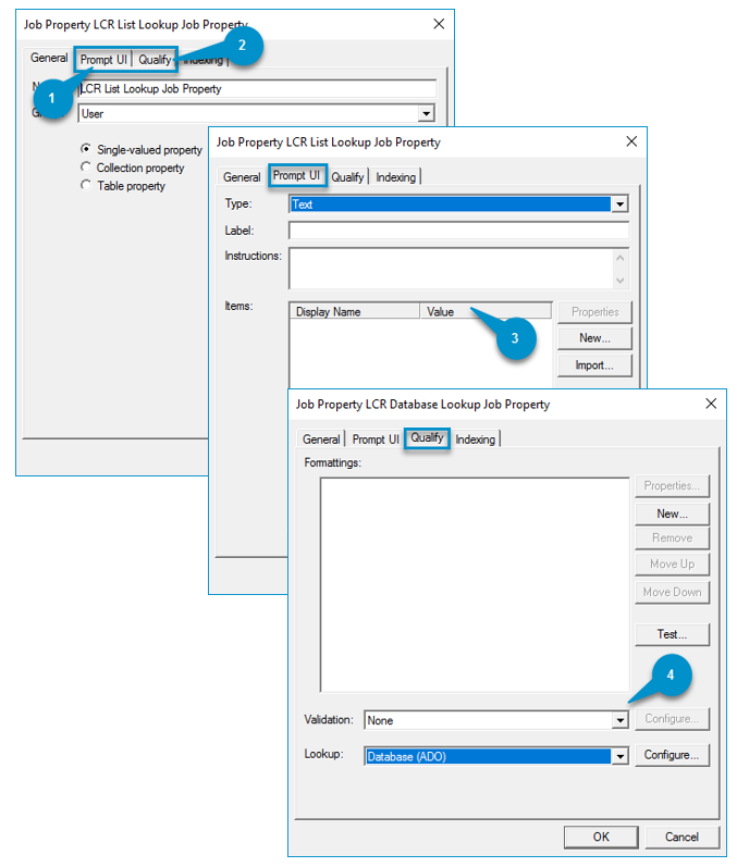

There are 2 Lookup types.
  • Prompt UI (Item-based List) – This Lookup is based on a list of items configured by an Administrator. The selected item's internal value is applied to a job. When the server searches the list of items, the Lookup is not case-sensitive and performs a "contains" search. For example, if the user types "INV01", the server searches for values that contain or match values like INV01-001, ENG-inv01, and ENG-INV01-001.
Note: The list of items is defined by using the Job Property > Prompt UI tab. No additional configuration is required. A message appears if the Configure button is incorrectly selected when using the Qualify tab.
  •  Database ADO (similar to Database Validation) – This Lookup is based on a database configured by an Administrator. The message server executes the database lookup using its credentials when communicating with the database. The Administrator can provide different credentials to use with a DSN (Data Source Name), if necessary. In addition, an Administrator must use the Configure button to configure this type of Lookup and provide a DSN and query to use. The SQL Select clause determines how the items will be matched which includes "starts with", "ends with", "contains" and other search strings.
Note: No DSN/Table is provided with the server installation. A DSN/Table that meets a company’s requirements must be provided by the Administrator for the database Lookup configuration.

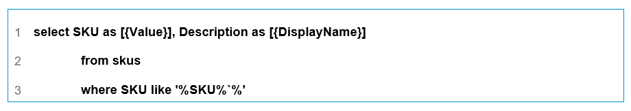

The query must reference the lookup job property (via substitution); for example, %lookupjobpropertyname% and specify the display text and internal value columns by using an "as" clause.
See the Query (SKU job property) example below.
The server expects {Value} and {DisplayName} to be returned from the database when the Lookup function is applied. Other columns returned are ignored.
Note: The example above uses “like” and the percent symbol (%) wildcard character. This is what the server uses to determine substitution. A back tick character (known as a back apostrophe) (`) must be included in the quoted string as shown above. The back tick is used to ignore  the percent symbol and not process it as part of a substitution. This allows it to pass through the SQL engine where it is used as the "like"  wildcard character.
