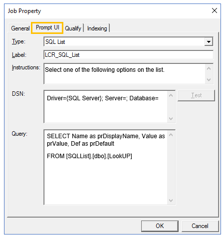

Select the Prompt UI tab.
Select SQL List on the Type drop down list.
Specify the instructions you want the user to see in the Instructions box (optional).
Specify the DSN parameters in the DSN box.
See the DSN syntax example below.
Example: Driver={SQL Server}; Server=; Database=
Parameters are separated by using the semicolon. Your values must be entered after the equal (=) symbol.
Specify the Query parameters in the Query box.
prDisplayName represents the prompts users will see. prValue represents the data that will be passed through. A default value can also be included in the query if necessary.
See the Query syntax example below.
Example: SELECT Name as prDisplayName, Value as prValue, Def as prDefault
FROM [SQLList].[dbo].[LookUP]
In the example above, the Query parameters must be replaced with your actual parameters. [SQLList] is the name of the database you specified in the DSN parameters. [dbo] is the default user created by the database server for each database. [LookUp] is the name of the table being queried.
14. Select the Test button. The Test Lookup dialog box appears.
15. Specify your Test parameters.
16. Select Test to ensure your results are accurate.
17. Select Close.

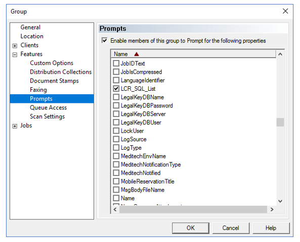

You can apply the SQL List prompt to specific user groups by selecting Configuration > Groups in the Server Administrator.
Note: Applying prompts to user groups is a standard step during configuration.
Start the Server Administrator if necessary.
Go to Configuration and select Groups.
Right-click on the appropriate group. The Properties shortcut menu appears.
Select Properties.
In the left pane, select Features > Prompts.
Select Enable members of this group to prompt…. check box.
See the Group Properties > Prompts dialog box example below.
7. Select the appropriate SQL List prompt.
8. Select OK.
