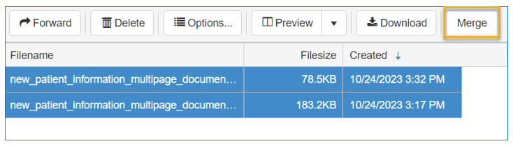

Users can create new PDFs from other PDFs by using the following My Files options.
  • Merge is used to combine individual PDFs into a new PDF. A new PDF is automatically created after the PDFs have been merged.
  • Split is used to split the PDF at a certain page. A new PDF is automatically created that includes the page where the split occurred and the remaining pages of the PDF, if any. The word “split” appears in the new filename.
  • Reorder is used to move pages up or down in the PDF.
  • Duplicate is used to duplicate a page in the PDF.
Note: Users cannot delete pages from the PDF.

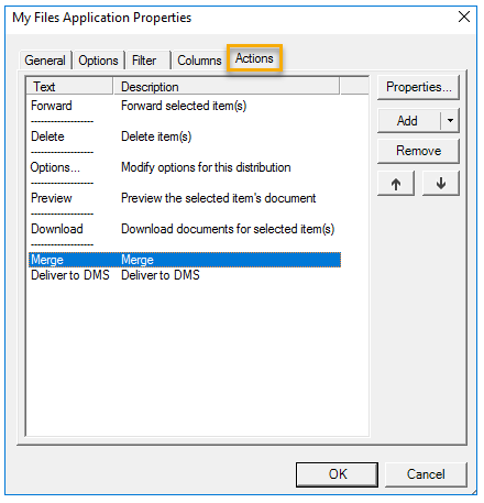

Before setting up groups and folders, ensure the Merge application property appears in the Actions list.
  1. In the Server Administrator, expand Configuration.
  2. Select WebApps. The profiles appear in the Details pane.
  3. Right-click the appropriate profile, for example, Default. The Properties short cut menu appears. See Creating a new WebApps profile for more information.
  4. Select Properties.
  5. Select the Applications tab.
  6. Select My Files. The My Files Application Properties dialog box appears.
  7. Select the Actions tab. The Merge action appears on the list as a default.
See the My Files Application Properties > Actions dialog box example below.
  1. Select OK on the My Files Applications Properties dialog box.
  2. Select OK on the Profile Properties dialog box.
