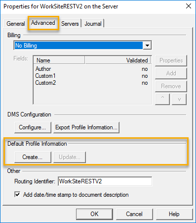

Note: The WebView2 message below appears if you attempt to create a default profile at the connector level.

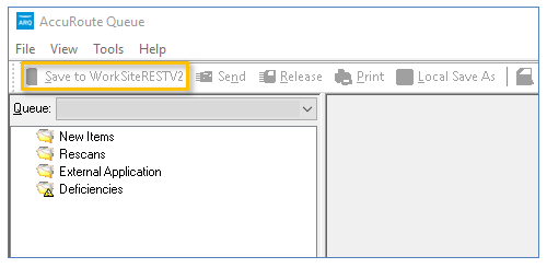

Note: The WebView2 message below appears if users attempt to save to WorkSiteRESTV2 at the queue level.

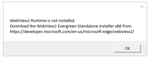

The following message appears if WebView2 has not been installed.
No additional setup is required in the Server Administrator and Client applications after WebView2 has successfully been installed.
