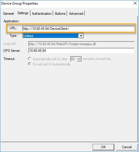

- Right-click the appropriate device group and select Properties. The Device Group Properties dialog box appears.
See the Device Group Properties dialog box below.
- Click the Settings tab.
Ensure you enter the fully qualified domain name and port number in the following format. See example below.

Example: https://fully_qualified_domain_name:port_number/DeviceClient/
