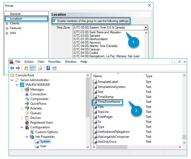

Group-specific Time Zones at a Glance
group location and time zone name job property dialog boxes
Group-specific Time Zones Legend
Description
1. Group Properties dialog box
Use the Group Properties > Location setting to enable members of a specific group to use the time zone selected.
2. Job Properties > System > TimeZoneName
Used by the server to verify the appropriate Group > Location setting, and date and time zone variables are applied to specific groups and their workflow cover page, fax top line, and email notification templates.
Note: This happens behind the scenes and does not require any additional configuration.
