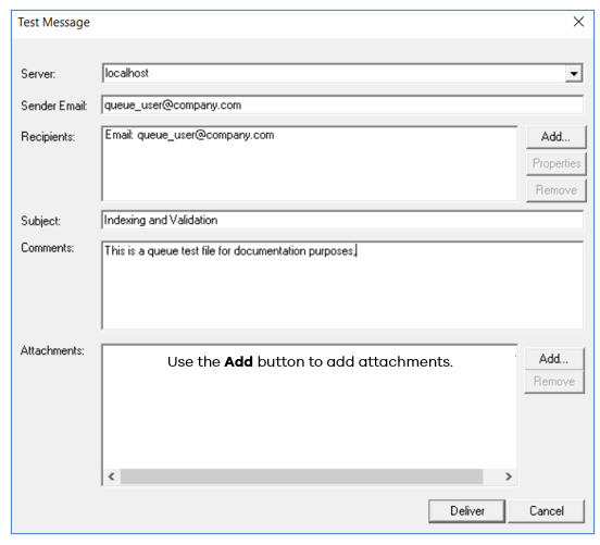

Administrators can create a test message in the Server Administrator to deliver a PDF with searchable text values to ensure jobs are delivered to the appropriate queue.

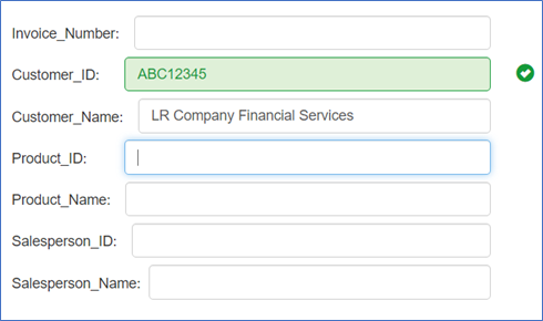

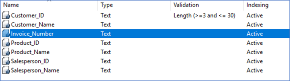

The predefined data fields and any validation set on the fields are presented in the panel on left. A preview of the invoice appears in the Preview panel on the right. The Customer ID data field has a length validation setting. In this example, any Customer ID selected must be within 3 to 30 characters long.

The Manual method is the most common and allows a queue user to manually enter values into the data fields. Based on the data field type, a queue user may also need to select options from a drop-down list.
  1. In the Data Fields Panel, click or tab to the appropriate data field.
  2. Enter or select a value.
See the Manual method example below.
