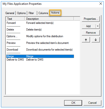

Before setting up groups and folders, ensure the Merge application property appears in the Actions list.
  1. In the Server Administrator, expand Configuration.
  2. Select WebApps. The profiles appear in the Details pane.
  3. Right-click the appropriate profile, for example, Default. The Properties short cut menu appears. See Creating a new WebApps profile for more information..
  4. Select Properties.
  5. Select the Applications tab.
  6. Select My Files. The My Files Application Properties dialog box appears.
  7. Select the Actions tab. The Merge action appears on the list as a default.
See the My Files Application Properties > Actions dialog box example below.
myfiles application properties actions dialog box example
  1. Select OK on the My Files Applications Properties dialog box.
  2. Select OK on the Profile Properties dialog box.
Note: The other default actions listed including Merge will appear in the WebApps/HP CR Client > My Files toolbar.
