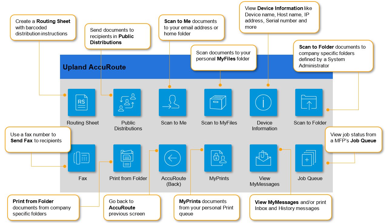

Administrators can add a variety of buttons to supported devices for their Device Client users. Each button has it's own unique functionality to meet a company's document workflow requirements. The following buttons and respective properties can be added to supported devices.
Device Information
Hold, Release or Send a Fax
Personal Distribution
Print Dynamic Form
Print from Folder
Public Distribution
Routing Sheet
Scan to Email
Scan to Folder
Scan to Me
Scan to MyFiles
View Job Queue
View MyMessages
View MyPrints
Device Buttons at a Glance
Note: This is an example. The buttons on your device may appear differently.

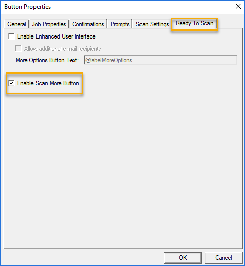

Enabling/Disabling the Scan More button
Administrators can choose to enable or disable the Scan More button from appearing on a device. The Scan More button by default appears automatically on a device. The button can be disabled by using Devices in the Server Administrator. See Adding Device Buttons for more information.
To disable the Enable the Scan More Button setting
In the Server Administrator, expand Devices.
Right-click the appropriate device group.
Select Properties.
Select the Buttons tab.
Select the appropriate button.
Select the Ready to Scan tab on the Button Properties dialog box.
Select the Enable Scan More Button setting check box to clear the setting.
See the Button Properties > Ready to Scan dialog box example below.
Select OK on the Button Properties dialog box.
Select OK on the Device Group Properties dialog box.

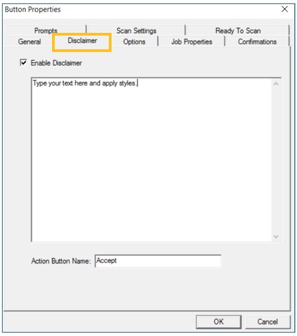

Administrators can add a disclaimer or customized content for use as a splash screen to any device button. The information is displayed after the button is selected by the device user. Several style attributes can be applied to the text to make it stand out.
To add a disclaimer or customized content
Select Properties.
Select the appropriate button. The Button Properties dialog box appears.
Select the Disclaimer tab.
See the Button Properties > Disclaimer dialog box example below.
Select the Enable Disclaimer check box. The text box area is enabled for text entry.
Type your text and apply the following style attributes as needed using the syntax below.
@style-font-name-XXXX@, for example, @style-font-name-arial@This text is using the Arial font.@end-style@
@style-bold@, for example, @style-bold@This text is bold.@end-style@
@style-italic@, for example, @style-italic@This text is italic.@end-style@
@style-normal@, for example, @style-normal@This text is normal.@end-style@
@style-font-size-XXXX@, for example, @style-font-size-20px@This text has a font size of 20 pixels.@end-style@
@style-color-XXXX@, for example, @style-color-red@This text is red.@end-style@
Note: Use the end style attribute, @end-style@, to turn off the attribute.
Use the default Action Button Name or type a different name, for example, Continue.
