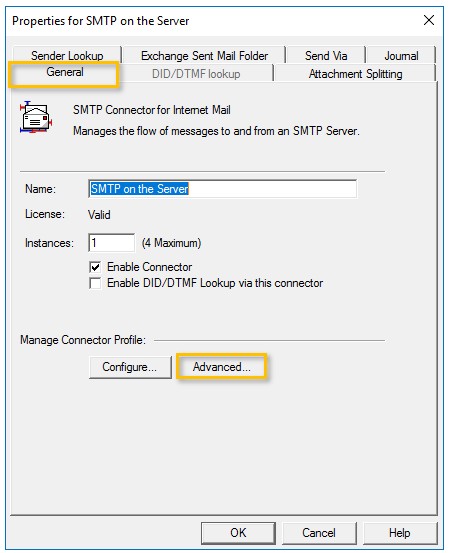

To set up SMTP Inbound
  1. In the Server Administrator, go to Connectors.
  2. Select SMTP on the Server. The SMTP on the Server Properties dialog box appears.
See the SMTP Inbound Properties > General dialog box example below.
smtp on the server properties general dialog box
  1. On the General tab, select Manager Connector Profile > Advanced. The Advanced SMTP Configuration dialog box appears.
