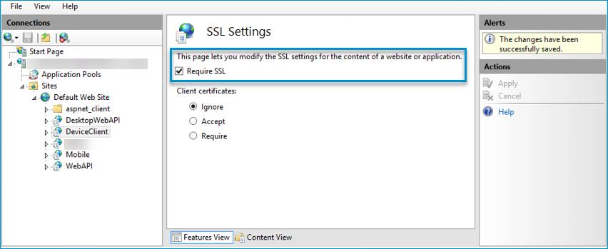

  1. Select Device Client below Default Web Site on the Connections pane.
  2. Go to the IIS area and select SSL Settings.
  3. Select Enable > Require SSL. The changes have been successfully saved alert appears.
See the Device Client > SSL Settings > Require SSL option below.
device client ssl settings require ssl option
  1. Select Web API on the Connections pane.
  2. Select SSL Settings in the IIS area.
  3. Select Enable Require SSL.
