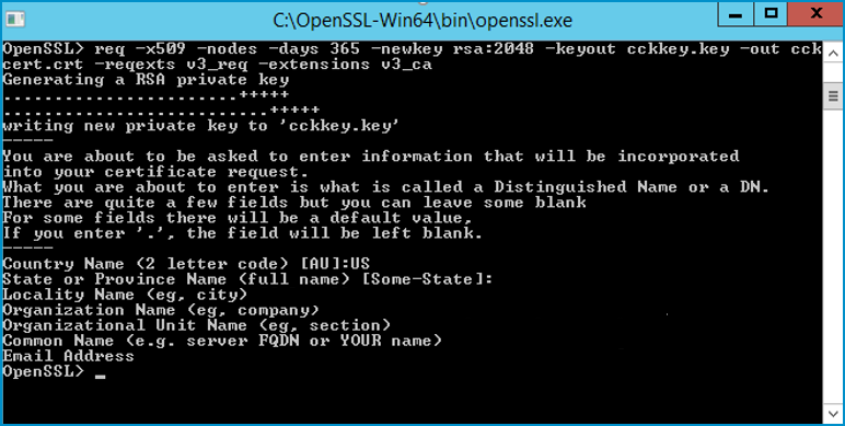

See the OpenSSL.exe file example below.
openssl executable file
  1. Type the following information that will be included in your certificate request and press Enter.
    • Country Name; for example, US
    • State or Province Name; for example, TX
    • Locality Name; for example, Austin (City)
    • Organization/Company Name; for example, Upland Software
    • Organizational Unit Name; for example, AccuRoute Server Administration (Department)
    • Common Name; for example, server FQDN (Fully Qualified Domain Name = hostname.domainname.com)
    • Email Address; for example, username@company.com
Note: Some of these fields can be left blank. A Self-Signed CA certificate (certificate.crt) is created and a Private key (privateKey.key) is generated when you are done.
