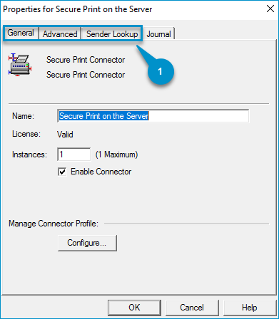

1. Secure Print Connector Properties dialog box
Use to set up the Secure Print Connector (SPC).
  • General tab
    • Specify or modify SPC name.
    • View or modify SPC license instances.
    • Enable or disable SPC connector.
  • Advanced tab
    • Specify or modify SPC folder to scan.
    • Specify or modify  SPC lookup failure email address.
  • Sender Lookup tab
    • Specify or modify SPC connection and search sender lookup parameters.

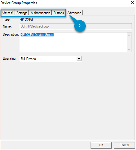

2. Device Group Properties dialog box
Use to set up Device Group with MyPrints button.
  • General tab
    • Specify or modify name, description, licensing and attribute map type default parameters.
  • Settings tab
    • Specify or modify Application, Web API, Ops Server, and Timeout default parameters.
  • Authentication tab
    • Specify or modify authentication type and LDAP lookup defaultt settings.
  • Buttons tab
    • Specify or modify MyPrints button and job properties.
