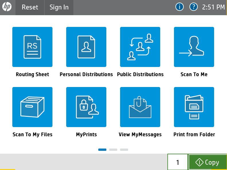

  2. The device client user signs in at the device. The Device Home screen appears.
device home screen
  1. The device client user selects MyPrints. The My Prints: Pending Print screen appears.
