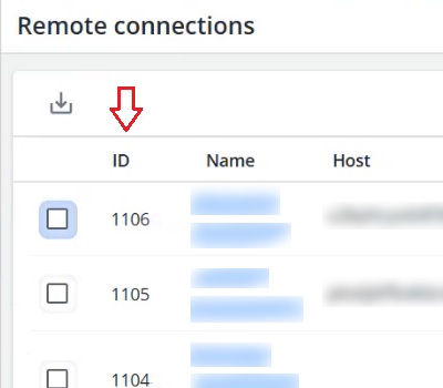

  14. Note the ID of your newly created Adestra-Blackbaud connection. This can be found in the remote connections table.
    Screen capture showing the location of the remote connection IDs within the Adestra app.
  15. Contact your customer success manager with the Remote connection ID so it can be added to the middleware database.
