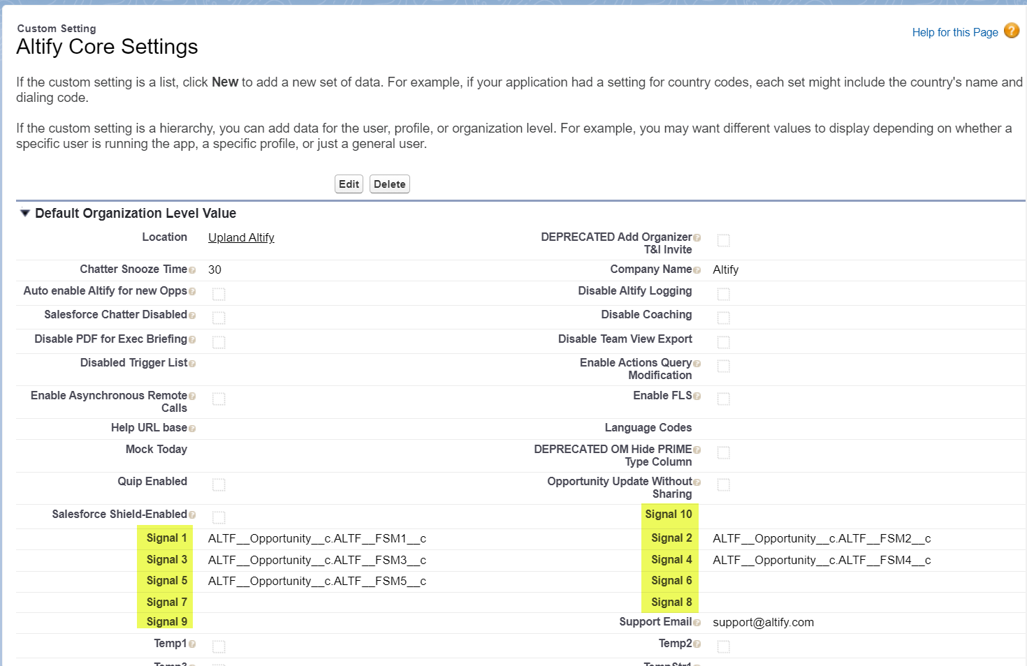

Altify recognizes these fields as Plan Status icons because they are added (by default) in the Altify Core Settings (Signals 1 to 5 below). The additional five settings (Signals 6 to 10) means you can create more icons if required.

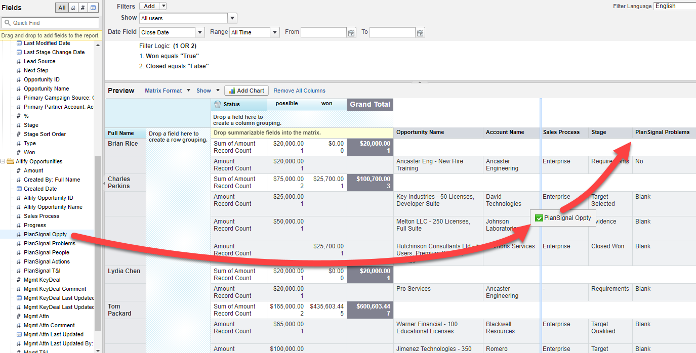

Adding the New Fields to a Report
With the fields already added to the relevant report type, carry out the following steps:
- In Salesforce Classic mode, open the Reports tab.
- Open the relevant report.
- Drag the fields listed above into the details area of the report (to the right of the "summarizable fields" area).
- Click Save.
Omit any fields that you don't want to be available in the view.
An alternative way of setting up the Mgmt fields is to drag them into the "summarizable fields" area, setting them to Sum. Doing this means that they are represented as both summary totals and as icons in the details area.
