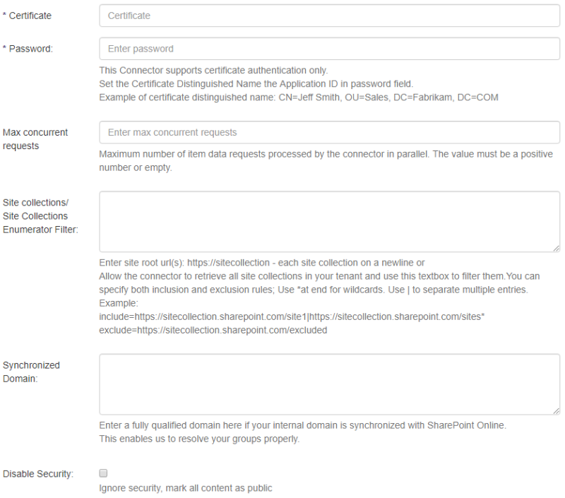

Set the Connection: Certificate Authentication
- After setting your generic information, click the Connect or Refresh Web Service link.
- The page refreshes and displays additional settings.
In the Certificate field, enter your Certificate common name. The Connector supports certificate authentication only.

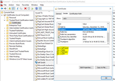

If you copy your certificate details, as shown in the Certificate console graphic below, your syntax will contain unnecessary spaces.
You must ensure you enter your certificate information in syntax without spaces or your certificate will not work.
CORRECT SYNTAX example: "CN=Jeff Smith"
INCORRECT SYNTAX example: "CN = Jeff Smith"
In the Password field, enter the Application ID.
This is a GUID such as "c87a7836-a1da-455c-9171-836bf793c195".
- Site collections/Site Collections Enumerator Filter:
- This value depends on your use case.
- Typically, users enter a site collection with inclusion (
*) set. - This captures all of the sites with the base URL.
- If you are using a Site Collection Enumerator, the format is described under the field in the user interface.
- Use the include and exclude keywords, followed by a list of site collections.
- Multiple site collections are separated by the pipe character |.
- Wild cards (*) are valid.
For example:
include=https://sitecollection.sharepoint.com/site1| https://sitecollection.sharepoint.com/sites*
exclude= https://sitecollection.sharepoint.com/excluded
- If you are not using the Site Collection Enumerator, enter one site collection to be crawled per line.
- Synchronized Domain: Enter the fully qualified domain name of the internal domain synchronized with your Azure Active Directory.
- Disabled Security: Check to disable security. This results in no content be scurity-trimmed.

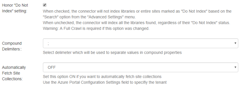

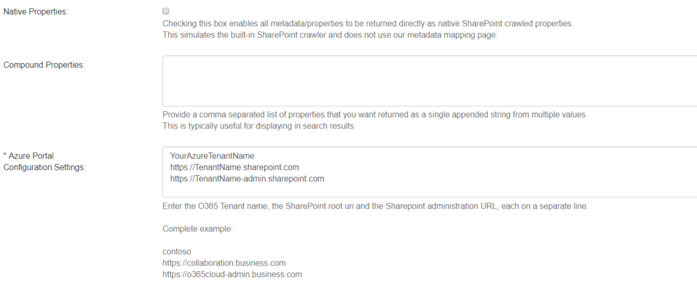

Refer to the graphic below for sample values.- Native Properties:
- Used only for Connector Framework implementations.
- Checking this box enables all metadata/properties to be returned directly as native SharePoint crawled properties.
- Compound Properties:
- Provide a comma-separated list of properties to be combined and returned as a single appended string from multiple values.
- Azure Portal Configuration Settings:
- Enter the following values in the following order, as shown in the graphic below, one per line:
- Tenant name
- Audience URI
- Admin URL
