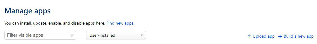

  1. Log in to Jira as a System Administrator.
  2. Click the gear icon and select Manage Apps.
  3. Select Manage Apps from the menu on the left side.
  4. Click the Upload app link.
  5. Upload the ApiExtension-1.0.jar file.

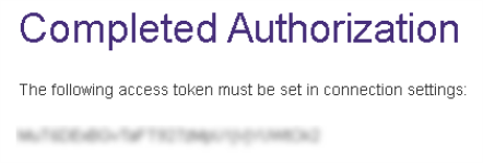

  6. Follow the on-screen prompts to log in using the credentials of the crawling user account.
  7. When the authorization process is complete, an access token is displayed on the screen.
    1. Copy and save this token.
    2. It is needed later, when a connection is created.

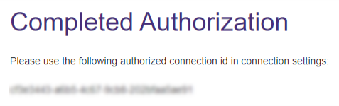

  5. When the authorization process is complete, an authorized connection id is displayed on the screen.
    1. Copy and save this id.

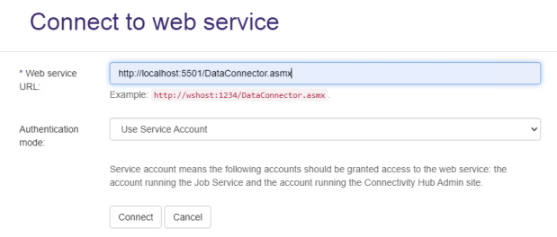

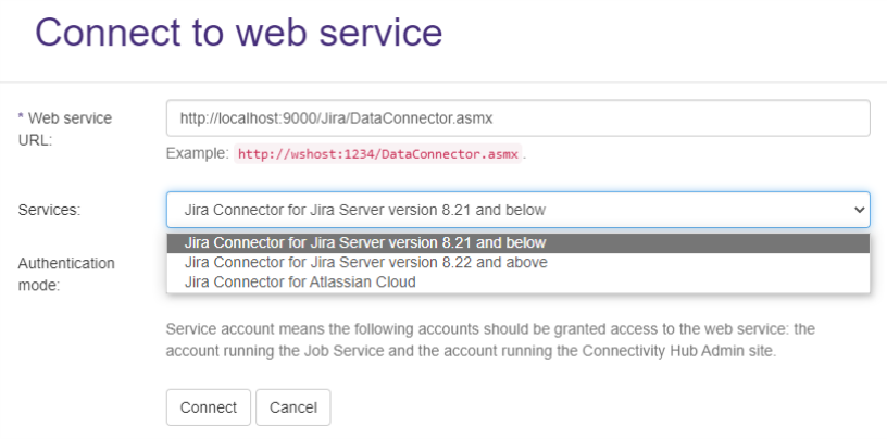

    1. If you do not have a Jira connection, create one by a creating a new Web Service connection.
    2. Use the URL to your Jira connector as specified in IIS, with "DataConnector.asmx" appended as shown in the example.
    3. Select Jira sub-connector according to the version of your Jira Server:

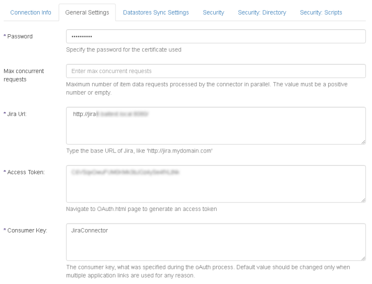

    4. Read and enter values (or enter check mark) into all available fields.
      1. Password:
        1. Certificate password, as specified in the topic "Generate the Authorization Token" below.
      2. Jira URL:
        1. Use this URL in Web browsers to reach the Jira UI.
      3. Access Token (Jira version 8.21 and below):
        1. This token is required for authentication, and is generated in the last step of the "Generate the Authorization Token" section.
      4. Consumer Key (Jira version 8.21 and below):
        1. The consumer key specified during the oAuth process.
        2. Default value should be charged only when multiple application links are used.

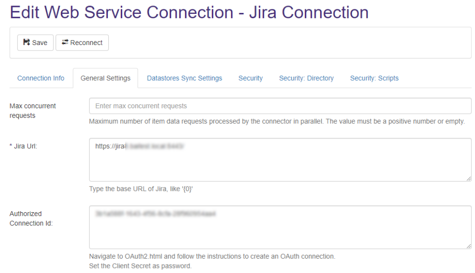

      5. Authorized Connection id (Jira version 8.22 and above):
        1. This identifier was generated in the last step of the "Generate the Authorization Token" section.

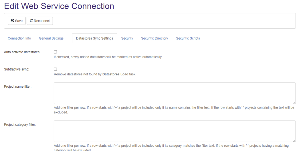

  4. Click the "Datastore Sync Settings" tab.
    1. Auto activate datastores
      1. Check the box to automatically mark as active any newly added Jira datastores.
    2. Subtractive sync
      1. Remove datastores not found by by the connector Datastores Load task.
    3. Project name filter
      1. Enter one filter per row.
      2. If a row starts with '+' a project is included only if its name contains the filter text.
      3. If the row starts with '-' projects containing the text are excluded.
    4. Project category filter
      1. Add one filter per row.
      2. If a row starts with '+' a project is included only if its category matches the filter text.
      3. If the row starts with '-' projects having a matching category are excluded.

    1. If you do not have a Jira connection, create one by a creating a new Web Service connection, using the URL to your Jira connector as specified in IIS, with "DataConnector.asmx" appended as shown in the example.

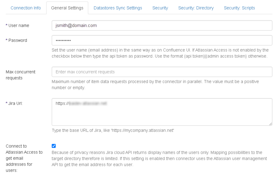

    2. Read and enter values (or enter check mark) into all available fields.
      1. User name: Login name of the administrator who generated the API token.
      2. Password: API token or API token and admin key based to the check box at the end.
        1. Token and key can be generated as described in previous sections.
      3. Jira URL: Use this URL in Web browsers to reach the Jira UI.
    2. Subtractive sync
