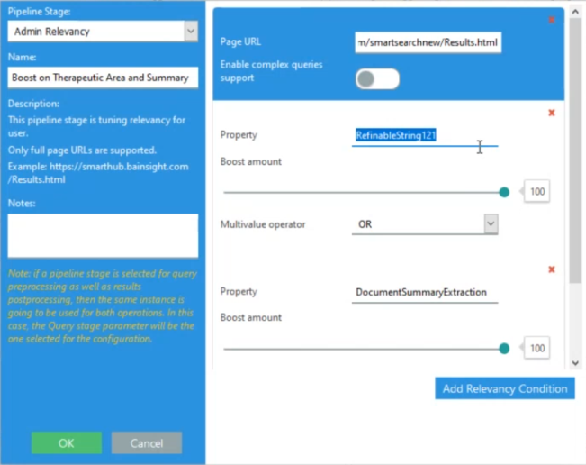

  • For example, an Elastic backend may have the following mappings (provided for example purposes, only), associated with the example values shown in the screenshot below:
Elastic Source System Property UI Property
"RefinableString121"
Title secondary
"DocumentSummaryExtraction"
Summary
Admin Relevancy Set After Property Mapper Stage
If the Admin Relevancy stage is placed after the Property Mapper stage, the properties specified in the "Property" field must be source system properties.
In the example below, the source system properties defined are the source system properties "RefinableString121" and "DocumentSummaryExtraction."

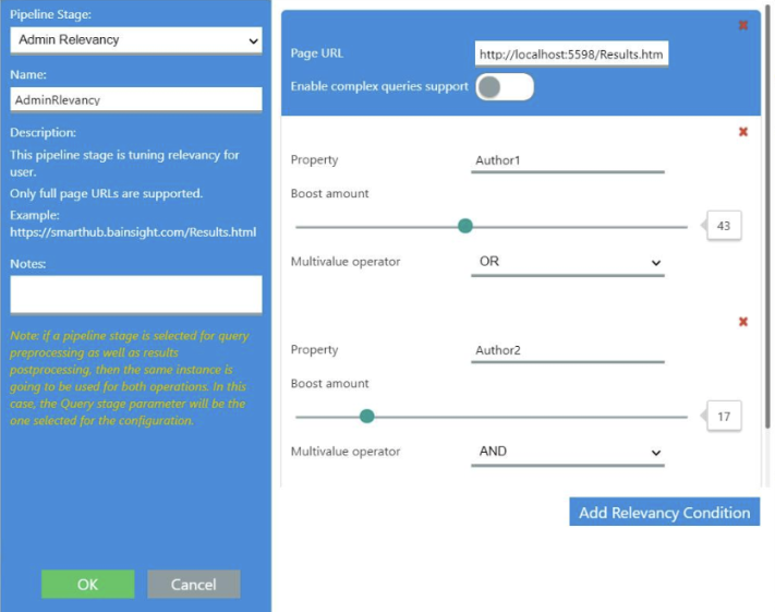

Example: Boost "Author" Relevancy
In this example, you want to manually boost the "rank" of author names, so that more documents with that term in the document's metadata type Author, are listed higher, at the top of your search query.
  • You apply a boost to the metadata type Author
    • Any documents with the term "Ph.d" categorized as metadata "Title", are given more weight and are returned at the top of your search queries.
This pipeline stage used to boost the metadata, or property, Author, would look like this:
