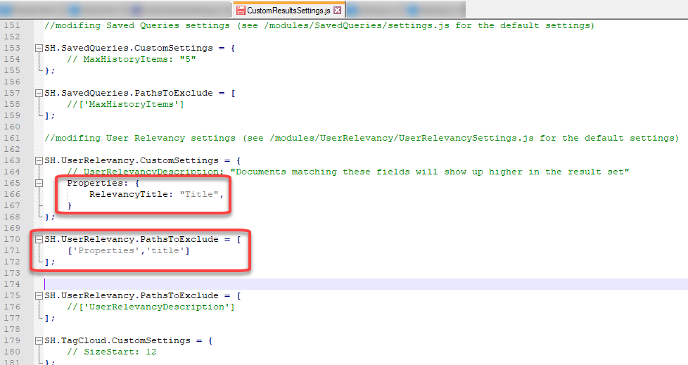

  2. Add the following code to your custom settings file, (around line 163 for Results settings and 149 for Index settings), as shown in the graphic:
    Copy
    SH.UserRelevancy.CustomSettings = {
    Properties: {
    RelevancyTitle: "Title",
    SH.UserRelevancy.PathsToExclude = [
        ['Properties','title']

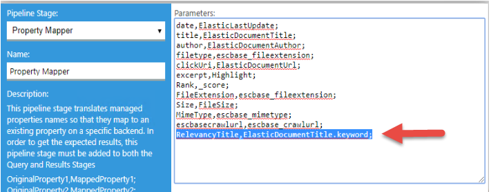

Map the New RelevancyTitle into the Property Mapper of SmartHub

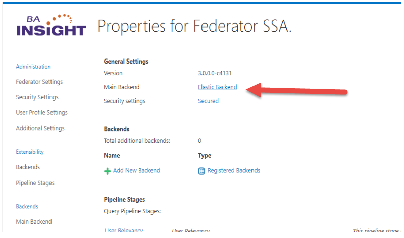

  1. Navigate to SmartHub/_admin.
  2. Click on the Backend.

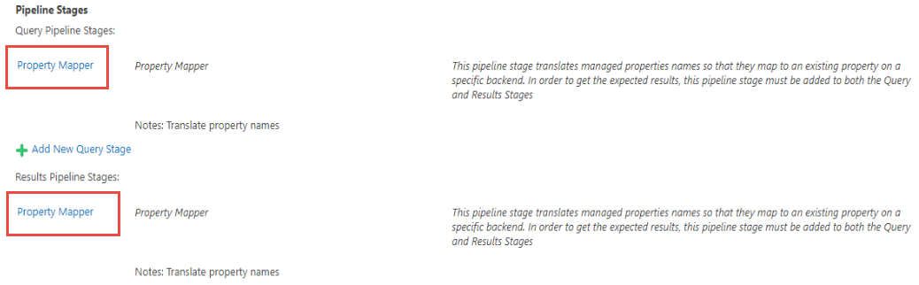

  3. Click on property mapper stages (update both query and results side property mapper stages).
  4. Add the line: RelevancyTitle,ElasticDocumentTitle.keyword;

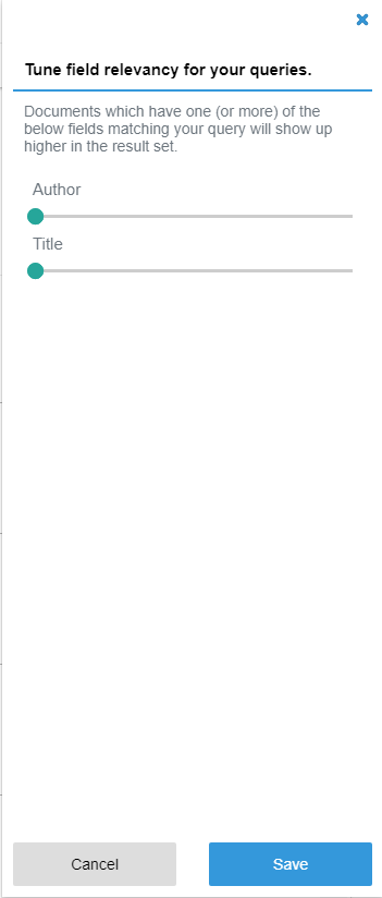

User Relevancy Component Example
