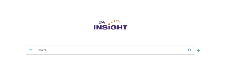

IndexCopy.html (landing page)
  • An exact copy of the default file Index.html.
  • Modify this file to change the appearance of your landing page, shown to the left.
  • Stores its settings by default in IndexCopyCustomSettings.js.
    • Instructions on modifying IndexCopyCustomSettings.js provided below.
  • Overwritten when SmartHub is upgraded.
  • If you do not rename this file, back it up and restore it after upgrading.

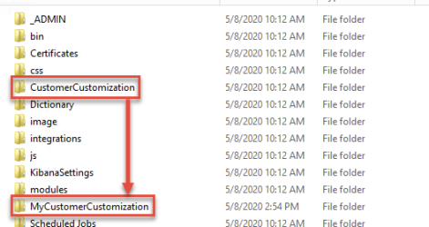

  1. Make a copy of its parent directory: <SmartHub root directory>\CustomerCustomization\
  2. Rename the new directory, such as MyCustomerCustomization.
  3. Open this file from its new directory.

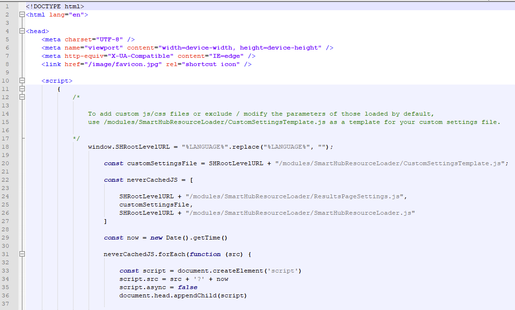

  5. Point to your custom Index settings file:
    1. Change the value of const neverCachedJS, around line 20, to the path of your custom settings file (by default, IndexCopyCustomSettings.js).
    2. Ex: "/MyCustomerCustomization/settings/IndexCopyCustomSettings.js",
  2. Rename the new directory if you have not already done so. Ex: MyCustomerCustomization.

    1. Change the value of const neverCachedJS, around line 20, to the path of your custom settings file (by default, ResultsCopyCustomSettings.js).
    2. Ex: "/MyCustomerCustomization/settings/ResultsCopyCustomSettings.js",

  1. ALL customizations are made to files contained in the "CustomerCustomization" folder.
  2. BA Insight recommends you leave the default folder as a backup.
  3. Before using the files in the "CustomerCustomization" folder, make a copy of it and rename the copy, as shown in the screenshot below.

  1. Copy the entire directory "<SmartHub installation root directory>\CustomerCustomization\"
    1. Creating a copy of IndexCopy.html and renaming the copy prevents any customizations from being permanently lost when the directory is overwritten at upgrade time.
  2. Rename your copy of the "CustomerCustomization" directory.

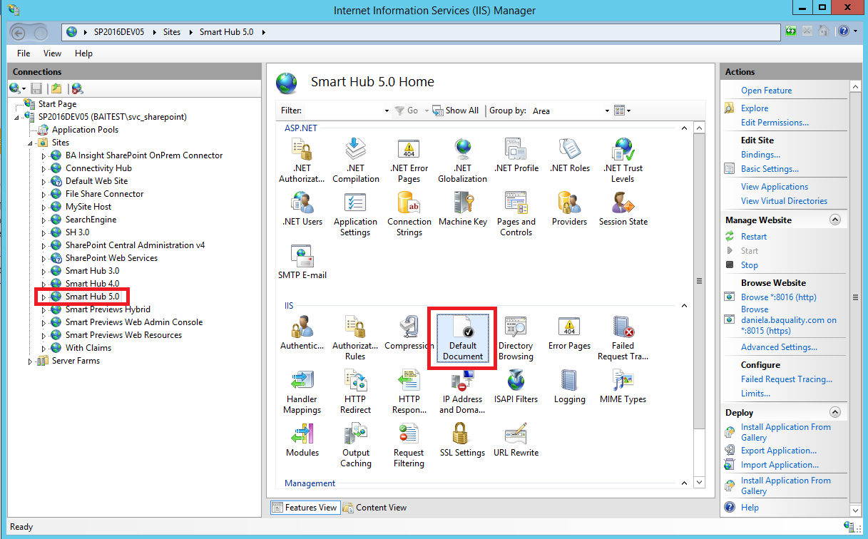

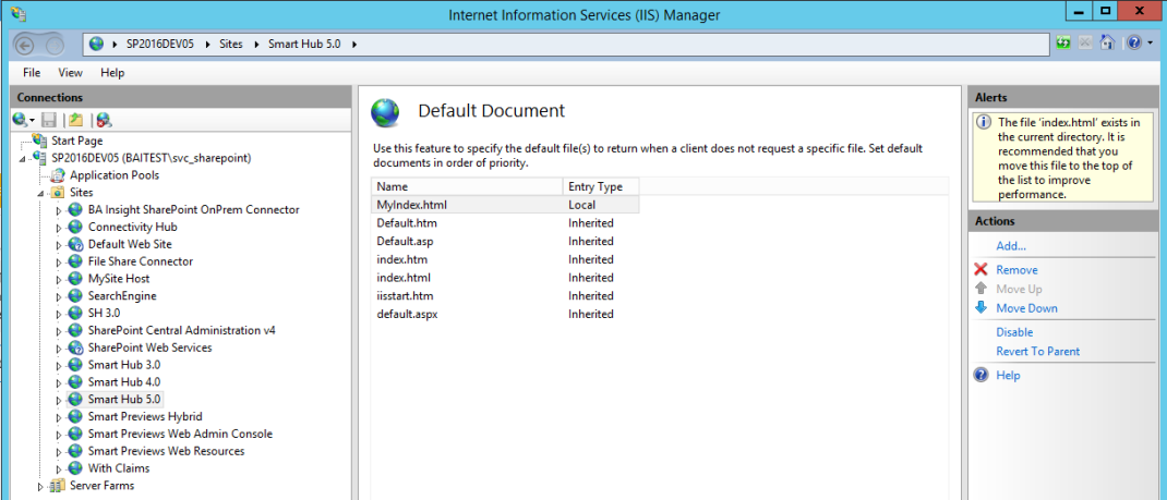

How to Set SmartHub to Use a Custom Index or Landing Page
Follow the steps below to direct SmartHub to load your custom Index.html file ("MyIndex.html" in the example below):
In the case of an upgrade, the setting of the "Default Document" from IIS is deleted.
Follow these steps to reset the IIS "Default Document" for your SmartHub site.
  1. Locate your custom Index page file (by default, IndexCopy.html).
  2. Open Internet Information Services (IIS), and select your SmartHub site.

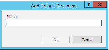

  3. Click "Default Document".
  4. Click the "Add" link under the Actions menu on the right side and enter the name of your custom Index file ("IndexCopy.html" or "MyIndex.html", for example) to add your index page as the default root page.
  5. Your custom Index file appears as the new default root page:

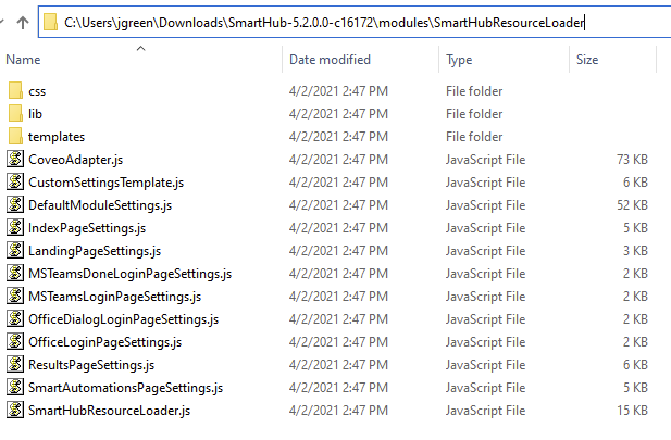

The SmartHub Web pages above are HTML files, but many of the page elements and behaviors are controlled by code in settings files which stored in the \modules\SmartHubResourceLoader directory.
See the table below:
SmartHub Page HTML file (in separate directory) Settings File Default Location (Settings Files) Description
Index or
"Landing" page
Index.html
IndexPageSettings.js /modules/SmartHubResourceLoader/
  • IndexPageSettings.js is the settings file used by Index.html.
    • Settings files control the appearance of the Index HTML page, and loads individual module/component settings.
    • DO NOT MODIFY
    • Overwritten at upgrade time
    • To customize, use the sister file IndexCopyCustomSettings.js described in the table below.

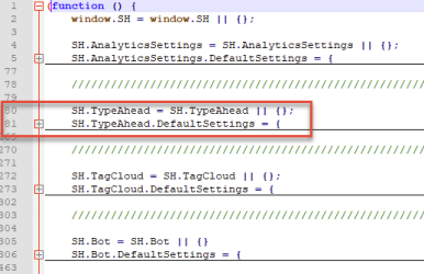

    • Example: Disable the ChatBot feature by copying the botDisabled setting from SH.Bot, around line 307 in <SmartHub root>\modules\SmartHubResourceLoader\DefaultModuleSettings.js into your custom Results settings file (shown below) and setting it to "true".
    • See How to Disable the ChatBot for more details.

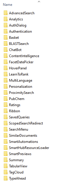

  • Each SmartHub component is found in its own directory, under \modules, as shown in the graphic below.
  • Each SmartHub component stores its settings in the same file: <SmartHub root>\modules\SmartHubResourceLoader\DefaultModuleSettings.js.
  • Component settings are used to change the behavior and/or appearance of the component.
  • To alter a component's settings, the settings are copied into the appropriate section of your custom settings file, and modified from there.
SmartHub \modules Directory Module/Component Documentation Topic/Description

The SmartHubResourceLoader is the first script that loads and is responsible for loading all the other components.
  • The SmartHubResourceLoader loads default components or modules (see the table above) through the DefaultModuleSettings.js settings file:
  • The landing page and query results pages load their settings separately:
    • On the page "Results.html" SmartHubResourceLoader uses the settings file "ResultsPageSettings.js" to load the settings on the (query) Results page.
    • On the page "Index.html" SmartHubResourceLoader uses the settings file "IndexPageSettings.js" to load the settings on the Index (start or home) page.
  • The code that loads the settings file is found at the top of any SmartHub page.
    • For example, the Results page (Results.html) is shown in the graphic below
      • The Results Page Settings file path is defined around line 24.
      • This default settings file can be overridden by entering the path to a custom settings file.
        • The path shown on Line 20 in the Results HTML file shown below can be changed to a custom settings file you define. See the table "SmartHub Web Pages: Custom" above.
      • Multiple custom settings files can be used. They are merged and loaded at run time.

  1. Copy the settings you want to modify from other settings files, such as TypeAhead.
  2. All module settings are found in the file <SmartHub root>\modules\SmartHubResourceLoader\DefaultModuleSettings.js.
    1. The TypeAhead settings are contained on line 81 in the DefaultModuleSettings.jsexample below:

  1. If you are loading any CSS files as part of your modifications, create them and store them in the folder for custom CSS:
    <SmartHub install root>\<Your>CustomerCustomization\styles, which also contains the CSS files for the Index and Results pages.

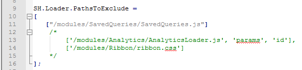

Example: Exclude the SavedQueries Module
Some users prefer not to load certain modules for various reasons, such as eliminating unwanted visual objects in the user interface.
  • To exclude a module from loading, locate the module - found within <SmartHubInstallation>/modules/<ModuleName>.
In the following example the SavedQueries module is excluded.
  1. The SavedQueries.js file is shown in the /modules/SavedQueries.js
  2. The following graphic shows our Custom Results Settings file (ResultsCopyCustomSettings.js).
  3. The path to the Saved Queries module is inserted within brackets [ ] under the "SH.LoaderPathsToExclude =" section (line 9 in the graphic below).
  • This excludes the SavedQueries module from loading.
