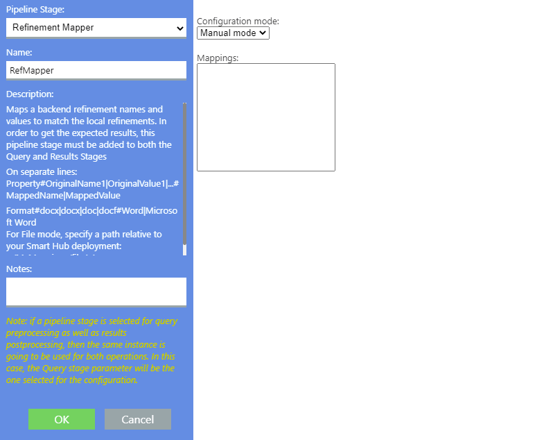

Manual mode
Provide mappings on separate lines in the following format:
  • Property#OriginalName1|OriginalValue1|...#MappedName|MappedValue
Example:
  • FileType#docx|docx|doc|doc#Word|Word

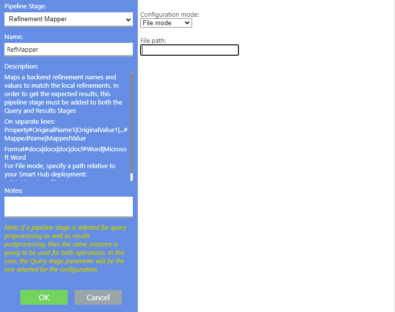

File mode
Provide a file path relative to the SmartHub deployment directory, for a file that contains mappings in the same format as above.
Example
  • SmartHub directory: C:\SmartHub
  • Path for file containing mappings: C:\SmartHub\MyMappings\file.txt
  • File path in Refinement Mapper: ~/MyMappings/file.txt
Example: Microsoft Word Documents
For example, enter the following code, on separate lines, in the format:
  • To map the document file types .doc and .docx to the name "Word" and .xlsx and .xls to the name "Excel" enter the following code:
FileType#xlsx|xlsx|xls|xls#Excel|Excel
