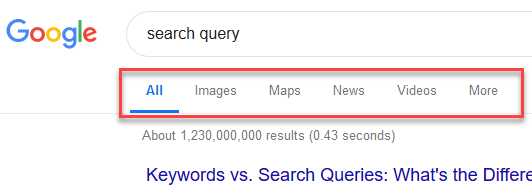

  • Google provides a similar feature, showing users specific categories for their search query after the query is performed. See below.
  • The ScopedSearchRedirect feature enables users to perform a similar categorical-type "scoped" search.

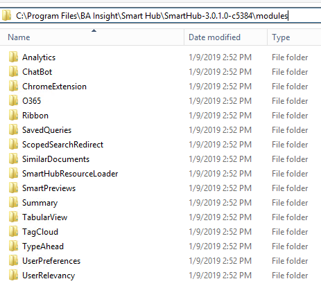

The ScopedSearchRedirect feature is a module located in the in SmartHub modules directory:

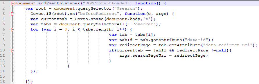

The ScopedSearchRedirect code appears below:

To be modified, the code above must first be copied into your custom settings file and then modified. See How to Customize Your SmartHub User Interface.
You can modify your custom settings file for either your Results.html page, Index.html page, or both.
