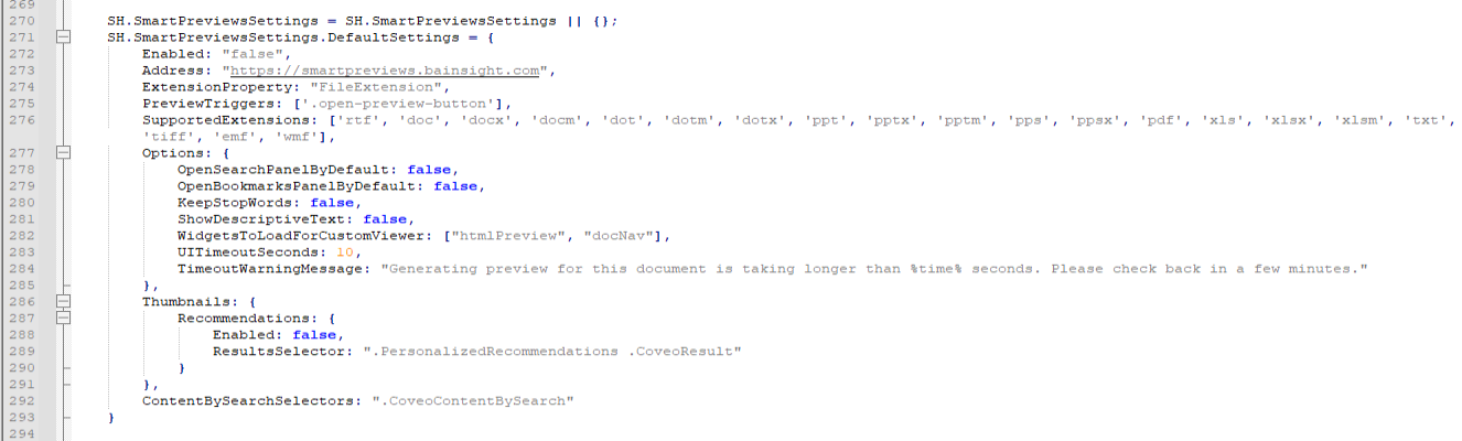

  3. Open the file DefaultModuleSettings.js, which contains all SmartHub Smart Previews settings around line 270. See below.
  4. Copy only the settings you want to change from the section SH.SmartPreviews.DefaultSettings.
  5. Go back to your custom Results settings file (DO NOT change any of the default settings, they are overwritten on upgrade)

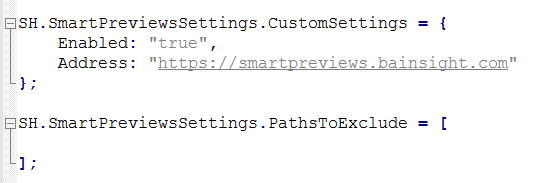

  6. Paste the copied settings inside the section SH.SmartPreviews.CustomSettings and change them accordingly:
    1. Enabled
      • Set to "true" to enable Smart Previews functionality.
    2. Address
      • Replace this value with the Smart Previews Web Resources site URL address.

Custom Settings Example:
