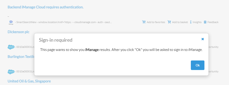

Remote Content Sources are backends which require log-in to the source system in order for users to get back results.
The user is prompted to log in to the source system whenever the current search page is configured to show results from a Remote Content Source.
You must enable and configure the Federated Impersonation Onboarding Module for the prompt to appear.

After Federated Impersonation Onboarding Module is configured, user authentication flow starts as described below.
  1. The user is prompted to authenticate to the Remote Content Source.
  2. The user is then redirected to the authentication page.
  3. After consent is granted, the user is redirected back to the search result page and the query is performed again, this time including the recently approved backends.
