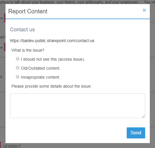

About the Result Feedback
The Result Feedback competent can be used by users to report content issues.
The Result Feedback button
can be found in the action bar for each result.
Clicking the button opens a modal window that displays:
- Result title
- Result URL
- The option to select the issue from three predefined issues:
- Access issue
- Old/Outdated content
- Inappropriate content
- The option to provide additional details about the issue with that result
- Click Send to send an email using your local email client.

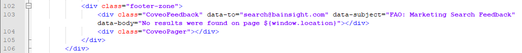

How to Customize the Page Feedback Component
To modify the Search Results Feedback component use the following instructions:
- Open your custom Results HTML file in an editor. See How to Customize Your SmartHub User Interface.
- Around line 103, you see <div class
"CoveoFeedback"under<div-class="footer-zone">. - The class
"CoveoFeedback"contains the modifiable attributes. See the graphic below. - Modify the class attributes as you desire.
Note: The objectwindow.location.hrefreturns thehref(URL) of the current page.
