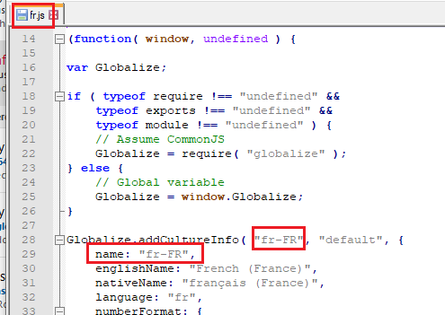

Language Example
If you edit any language files from the <SmartHub_root>\js\cultures directory, the language name appears and is independent of the language file name:
- fr.JS defines a language named fr-FR
- In your languageRedirects, in that case, you can use fr-FR so spellchecker looks for a dictionary named fr-FR.txt inside the SmartHub "Dictionary" directory.

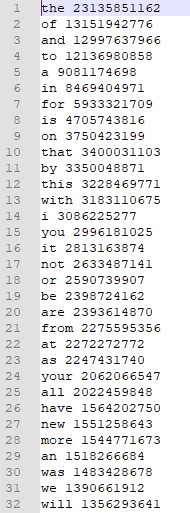

Dictionary Format and Term Frequency Settings
The dictionary contains:
- One line for each recognized term (word)
- Each line contains the term along with a number (between 1 and 9223372036854775807)
- The number represents the frequency of the term
- Spell checking suggestions are computed in descending order by their frequency and the top 1 is returned to the UI.
- Since there could be multiple possible suggestions for a typo, you should ensure the most frequent spelling of a term has the highest number in the dictionary

Sample of Lines in en-US Dictionary
How to Set the Most Frequent Words for Spelling Correction
Use a text editor to create new lines in the dictionary and assign a frequency number to them depending on how important/relevant they are in your environment.
Frequency number
Please note that the formula used to compute spelling suggestions is more complex than just numeric comparison between the frequencies but the general rule should be that the frequency of the words should directly correlate to "how many times would I find that word in the documents available at search time" - the higher the number the more relevant that word is
