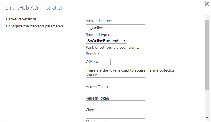

- Click Main Backend > Edit backend settings to see the Backend Settings pop-up window:
- Backend Name (required):
- Enter a unique name for your backend.
- This name cannot be duplicated and can contain only letters, digits, or any of the following characters:
' ', '-', '_', '.', '(', ')', '[', ']'
- Backend type: Select SpOnlineBackend.
- Rank offset formula coefficients (optional):
- These values are used only if you selected the Rank Based mixing algorithm that is set in the Properties for SmartHub SSA page.
For more information, see Specify the Mixing Algorithm.- BOOST: Enter the boost factor.
- OFFSET: Enter the rank offset.
- Enter the information used to access the site collection:

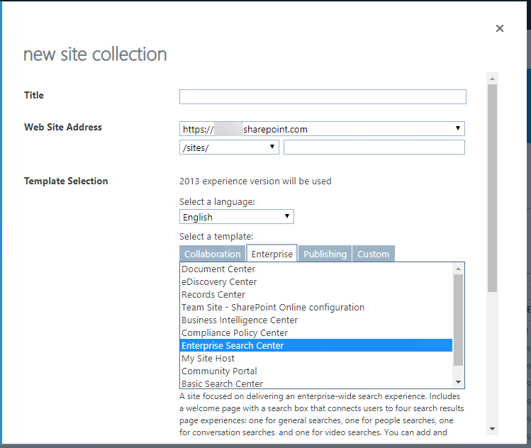

- Site url: Enter the URL for your SharePoint Online Search Center, which is a site collection created with a SharePoint "Enterprise Search Center" template.
- You may receive an error when performing a query if you do not use a Search Center URL in this field.
- Access Token: Enter the access token from SmartHub's OAuth page.
- Refresh Token: Enter the refresh token from SmartHub's OAuth page.
- Client Id: Enter the Application ID from Azure App Registrations.
- Client Secret: Enter the Key's value from Azure App Registrations.
- Company Signature (Optional): Enter the company signature. This is used to avoid getting throttled by SharePoint O365.
- Example: NONISV|Contoso|GovernanceCheck/1.0
- See here for more details on required format.
- Impersonate: Click to let SmartHub assume the identity of the specified account when retrieving data.
- If impersonation is checked you don't need to fill the rest of fields.
- Note: Azure Active Directory has to be configured in Security Settings
- After completing Site URL, Client ID and Client Secret, click Authorize and a new tab will open to login.
- After logging in, you are redirected to SmartHub's OAuth page where you can find the access token and refresh token. See How to register an app in Azure and configure it.
- Click OK to add this backend.
