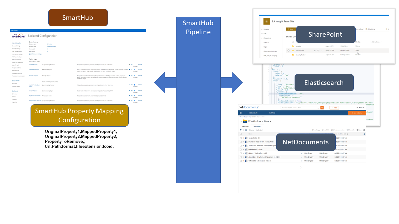

The Property Mapper is used by all SmartHub backends such as Elasticsearch, SharePoint, Solr, and others.
Use the Property Mapper pipeline stage configuration to translate the name of a managed property to the name of an existing property on a specific search engine (backend) such as Elasticsearch or SharePoint Online.
See the figures below and the section "Property Mapping Example" lower down on this page.

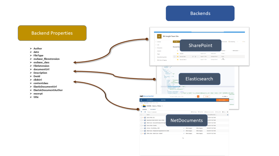

Problem: Properties by Different Names Across SmartHub Backends
Solution: SmartHub Property Mapping
Property Mapper Parameters
[LocalPropertyName,RemotePropertyName;]*
This stage must be added as both a Query and Results pipeline stage to each search engine (backend).

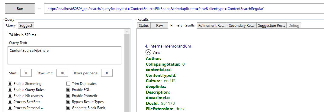

In this example the following conditions exist:
- Your search index stores document file extensions in a property named
escbase_fileextension - Your search interface expects a property named
FileExtension. - To apply a refiner or run a query that returns a file with a specific extension, you must map the
FileExtensionproperty from the UI to theescbase_fileextensionproperty in the index.
| User Interface Property |
Property stored in Search Index | Property Type (must be the same for both properties being mapped) |
------> | escbase_fileextension
String |

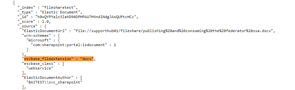

Example Index
The search index (backend) in this example contains the following properties:
- ElasticDocumentUrl
- escbase_fileextension: This is the only property mapped in this specific example.
- escbase_class
- ElastsicDocumentAuthor
Example Query
To map the properties in this example correctly, you must specify the following Property Mapper configuration:
FileExtension,escbase_fileextension
