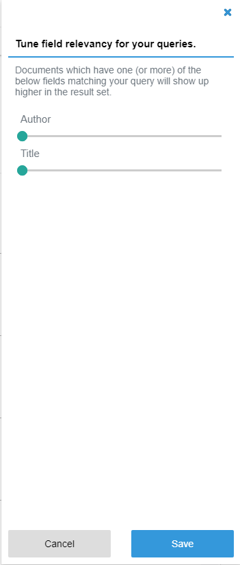

If you access Personalization from the Results page you see the following options:
  • Edit preferences
  • Tune relevancy

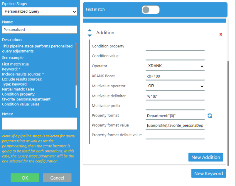

A personalized pipeline stage must be configured for Personalization to work.
The pipeline stage is called "Personalized Query."
More information about Personalized stage can be found here: How to Personalize User Queries

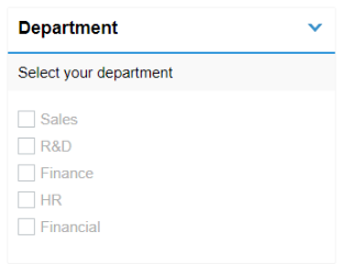

  1. In the top right, go to <user name>→ User Menu → Personalization.
  2. A pop-up appears displaying customization options.
  3. Select the Departments, Regions, Job Roles, Interests, or Projects you want relevancy tuning applied to.
  4. Once your selections are made, the effect on search results is immediately shown on the right side.

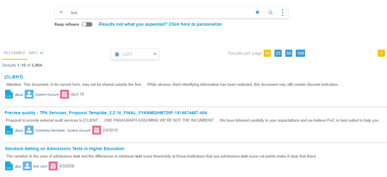

  5. The Personalization pop-up appears if you click the Results not what you expected link under the search field at the top of the page.

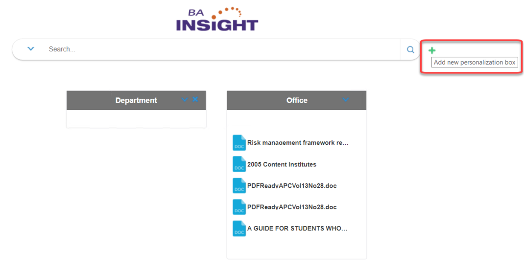

  6. On the landing page, the Personalization pop-up can be called by clicking the '+' (Add new personalization box) button, found next to the search field.

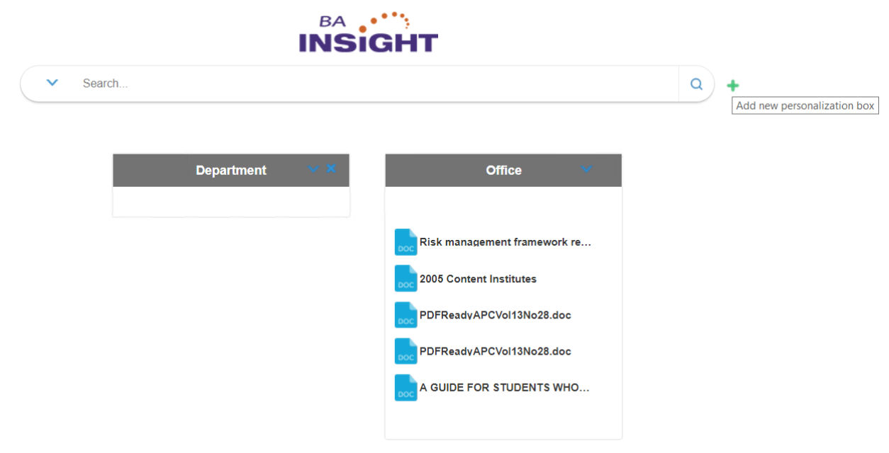

About Personas
Personasare identities that are assigned to individual users or a group of users.
  • An administrator can decide whichContent-by-Searchboxes (see the graphic below) each Persona may view.
  • Individual users have the ability to choose which content is hidden and which is displayed.
  • Aconditionattribute added on the Content-by-Search evaluates if the component should be displayed or not.
  • The module displays all the Content-by-Searches on the page where theconditionattribute returnstrue.
If Content-by-Search (CBS) components are not updated with theconditionattribute, all CBS components are displayed in theEditpage

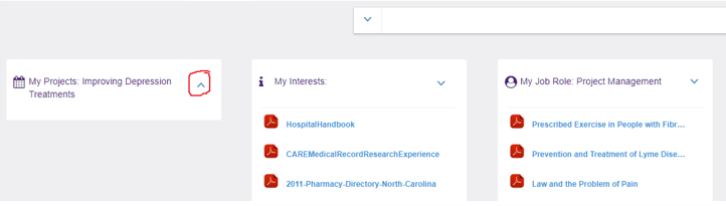

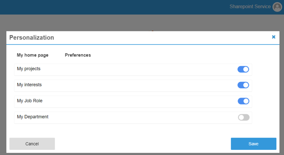

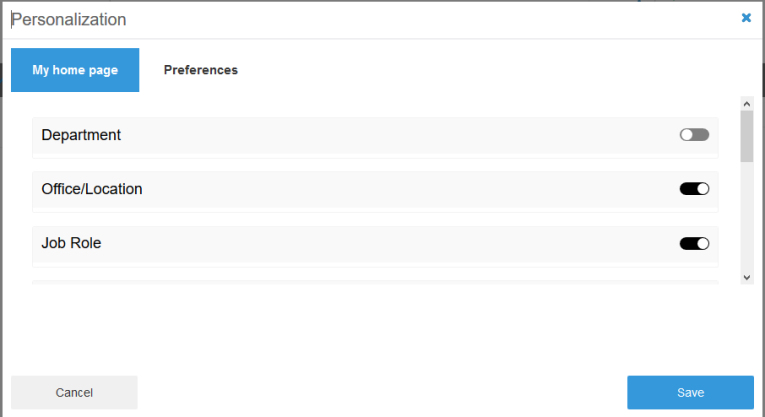

  1. To get to "My home page," access Personalization from the ribbon.
  2. Navigate to user preferences view under<your user name>>User Menu>Personalization.
  3. A popup appears that displays customization options.
    1. Enable/Disable: Click to display a live preview of these boxes on the result page.
    2. Cancel: Click to reset the values to the previously saved values.
  4. Save: The option is saved in the preferences and applied when each page is loaded. The option is saved per page.
  5. On the landing page, the Personalization popup can be called by clicking on the "Add new personalization box" button, found next to the Search box.

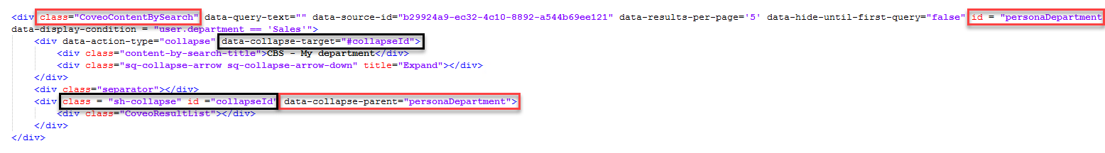

  • The Content-by-Search components must have their own uniqueIDso that they can be configured independent of each other.
  • The condition attribute is configured using the format:
    user.property== 'property value'
    For example:user.department == 'Sales'
The property and property value are case sensitive.
How to Enable Users to Collapse or Expand Boxes
If you want to enable your users tocollapseorexpandthe CBS boxes, you must add multiples classes to your Content-By-Search component.
Box Expand/Collapse Example
The following See the graphic below.
  • data-collapse-target:This value must be the same as the ID from the classsh-collapse.
  • data-collapse-parent:This value must be the same as the ID from the classCoveoContentBySearch.

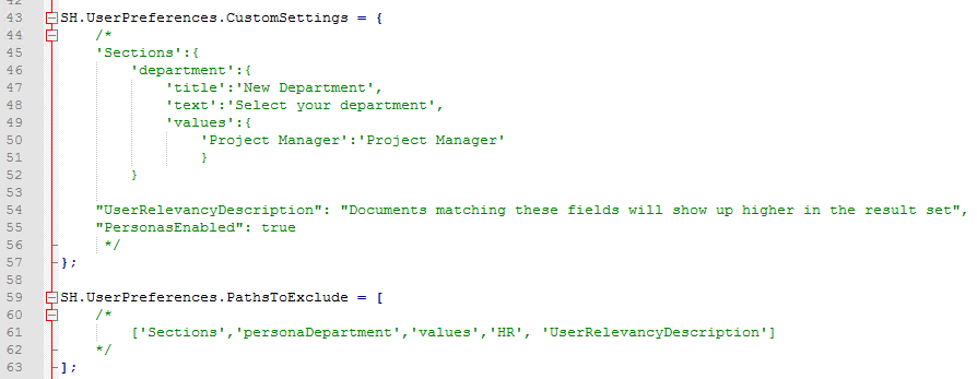

How to Exclude Out-of-the-Box Section Values from User Preferences
If you want to display your own sections under Preferences, and exclude the ones provided out-of-the box via the DefaultModuleSettings.js file, use the SH.UserPreferences.PathsToExclude object in your custom settings file to exclude them.
The SH.UserPreferences.PathsToExclude object is included in the default custom settings files in the root directory\CustomerCustomization\settings.
In the next example, a section called New Department is added.
It uses PathsToExclude to exclude the out-of-the-box sections.
Copy
SH.UserPreferences.CustomSettings = {
    'Sections': {
        'my_department': {
            'title': 'New Department',
            'text': 'Select your department',
            'values': {
                'Project Manager': 'Project Manager'
SH.UserPreferences.PathsToExclude = [
    ['Sections', 'department'],
    ['Sections', 'location'],
    ['Sections', 'jobs'],
    ['Sections', 'interests'],
    ['Sections', 'projects']

Relevancy Tuning
If you want to boost the relevance of properties (just until you refresh the page) in SmartHub, use the following procedure.
Customize the CustomSettingsTemplate.js file
Use theCustomSettingsTemplate.jsfile to make customizations which can be saved. You will OVERRIDE the “title” booster that was built in.
  1. Navigate to the CustomSettingsTemplate.js file.
    1. The default location of this file is:<Installation directory>\modules\SmartHubResourceLoader\CustomSettingsTemplate.js
  2. Add the following code as shown in the graphic:
Copy
SH.UserPreferences.CustomSettings= {
Properties: {
RelevancyTitle:"Title",
SH.UserPreferences.PathsToExclude= [
    ['Properties','title']

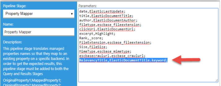

Map the New RelevancyTitle into the Property Mapper of SmartHub

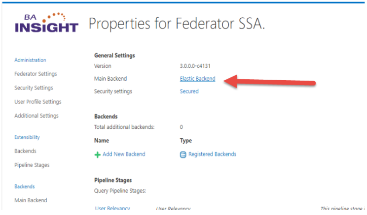

  1. Navigate toSmartHub/_admin.
  2. Click on theBackend.
  3. Click on property mapper stages (update both query and results side property mapper stages).
  4. Add the line:RelevancyTitle,ElasticDocumentTitle.keyword;

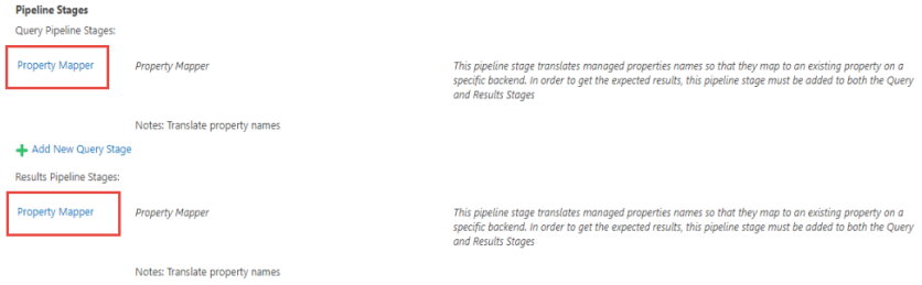

Navigate to the property mapper stages:
  1. Go toSmartHub/_admin
  2. Click on the Backend.
  3. The property mapper stages.
