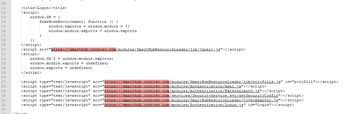

  3. Navigate to the SmartHub installation directory and copy the file Login.aspx to a different directory (for editing).
  4. Open the copy of the file Login.aspx for editing.
  5. Remove the first line (that starts with the <%@ Page directive).
  6. Update the src attribute for all the script tags: prefix the path with the full address to your SmartHub site (https://yoursite.com) as shown in the example below, (which uses the sample site https://smarthub.contoso.com):
  7. Save and close the edited file.

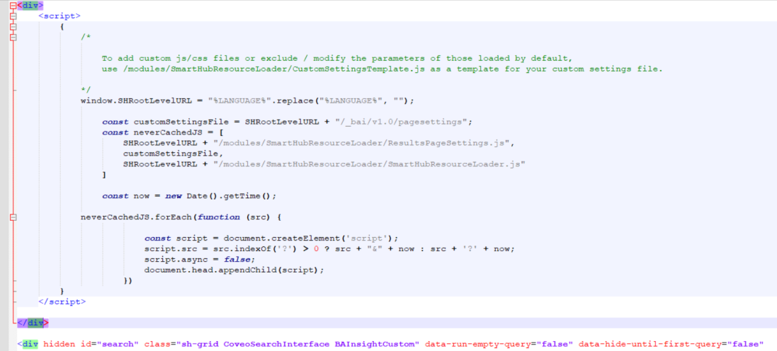

  11. Edit the file SPOEmbed-Results.html and make the following changes:
    1. Remove all the non-script tags from the head and everything above the <head> tag.
    2. Replace the <head></head> and <body></body> tags with <div> and </div> while keeping the inner contents of those tags:
    3. For the DIV with ID "search" add a new attribute data-main="true"
    4. Replace the src attribute of logo with absolute URL.

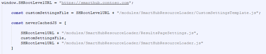

    5. Change the SHRootLevelURL value to your SmartHub root address, as shown below:

        const customSettingsFile = SHRootLevelURL + "/_bai/v1.0/pagesettings" + "/?page=" + encodeURIComponent("/customer/CustomResultsPage.html");
      3. The SPOEmbed-Results.html page should be reassembled as follows:
        Info: Notice that "/customer/CustomResultsPage.html" is the relative URL of your custom results page.

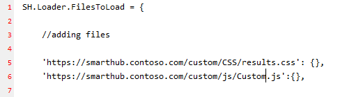

  12. Open the custom Results.html page settings file (used by the Results page) for editing.
  13. Change the URL to any custom CSS or JavaScript file that was added to it to use the full SmartHub URL instead of the relative URL (or to use the SHRootLevelURL as shown below):

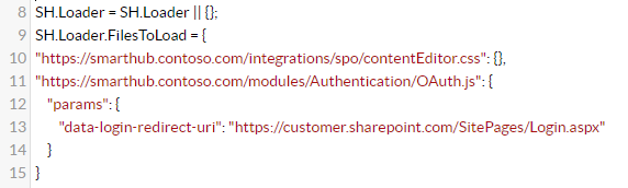

  14. In the custom settings file add the following code to the SH.Loader.FilesToLoad section.
    1. Add the URL to point to the location of custom style for content editor and other JavaScript/CSS files that you want.
    2. Add the URL to point to the location of the Login.aspx page that you uploaded to SharePoint in step 4, above:
      Copy
      LoginSnippet + ContentEditorStyle
      "https://smarthub.contoso.com/integrations/spo/contentEditor.css": {},
      "https://smarthub.contoso.com/modules/Authentication/OAuth.js": {
          "params": {
              "data-login-redirect-uri": "https://customer.sharepoint.com/SitePages/Login.aspx"
The complete, final settings file resembles the code shown below:

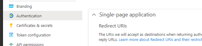

  4. Navigate to the Azure Portal App registration used by SmartHub authentication.
  5. Edit the list of Single-page applications (under Authentication).
    1. Add the URL to the Login.aspx page you uploaded to SharePoint, such as https://customer.sharepoint.com/SitePages/Login.aspx

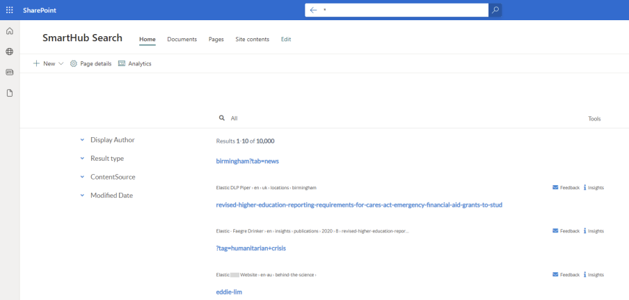

  7. In the web part properties enter the full URL to your custom SPOEmbed-Results.html page
    1. Example: such as https://smarthub.contoso.com/customer/SPOEmbed-Results.html
    2. In the case of a modern page, ensure you check the option "Make _spPageContextInfo available" in the BA Insight Content Editor web part options.
  8. Save the web part changes and publish the page.
