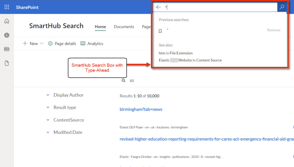

This page describes how to configure both of the following (see screenshot below):
- SmartHub SearchBox
- SmartHub Results UI (within SharePoint)

SmartHub Results UI in SharePoint with SmartHub SearchBox

- You see the following:
- The SmartHub Results UI does not display a SearchBox
- The SmartHub SearchBox in the SharePoint Suite Bar works and displays type-ahead as configured in the page's custom settings file
